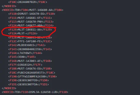

<NODEID>
712
<F110>DSMU5T-14F548-DB</F110>
<F111>MU5T-14G009-DC</F111>
<F113>MU5 T-14F548-DD</F113>
<F129>MU5 T-14G009-EA</F129>
<F159>030000</F159>
<F15C>051103</F15C>
<F15E>030804</F15E>
<F160>062500</F160>
<F161>021906</F161>
<F188>MU5T-14G003-DD</F188>
<F18C>2010</F18C>
</NODEID>
<NODEID>
7D0
<F10A>MU5T-14G680-AA</F10A>
<F110>DSMU5T-14G670-EG</F110>
<F111>MU5T-14G681-KF</F111>
<F113>MU5T-14G670-PNL</F113>
<F124>MU5T-14G677-ABA</F124>
<F129>ML3T-14G00T-18K811-AA</F129>
<F12A>ML3T-</F12A>
<F12B>ML3T-18B955-BE</F12B>
<F12C>FFF1-14F180-FE</F12C>
<F142>MLBE10218S</F142>
<F143>20210224041110</F143>
<F144>R3W9QDWA</F144>
<F16B>MU5T-14J003-AF</F16B>
<F17F>1SN12C11</F17F>
<F188>MU5T-14G676-EG</F188>
<F18C>FUBCH20346051212</F18C>
<F190>Vin Number</F190>
<F1D0>28385C047D1D</F1D0>
<F1D1>28385C047D1E</F1D1>
</NODEID>

The 712 (SCMG module) field F113, F129 are certainly Network Scan related corruptions. The 7D0 (APIM module) is not. I have see the F12A field like above on trucks that posted self-report and no network scan has been performed for a while (or at all)
If that's true then my UCDS adapter does not have the same J2534 passthrough corruption that occurs with the VCX Nanos
