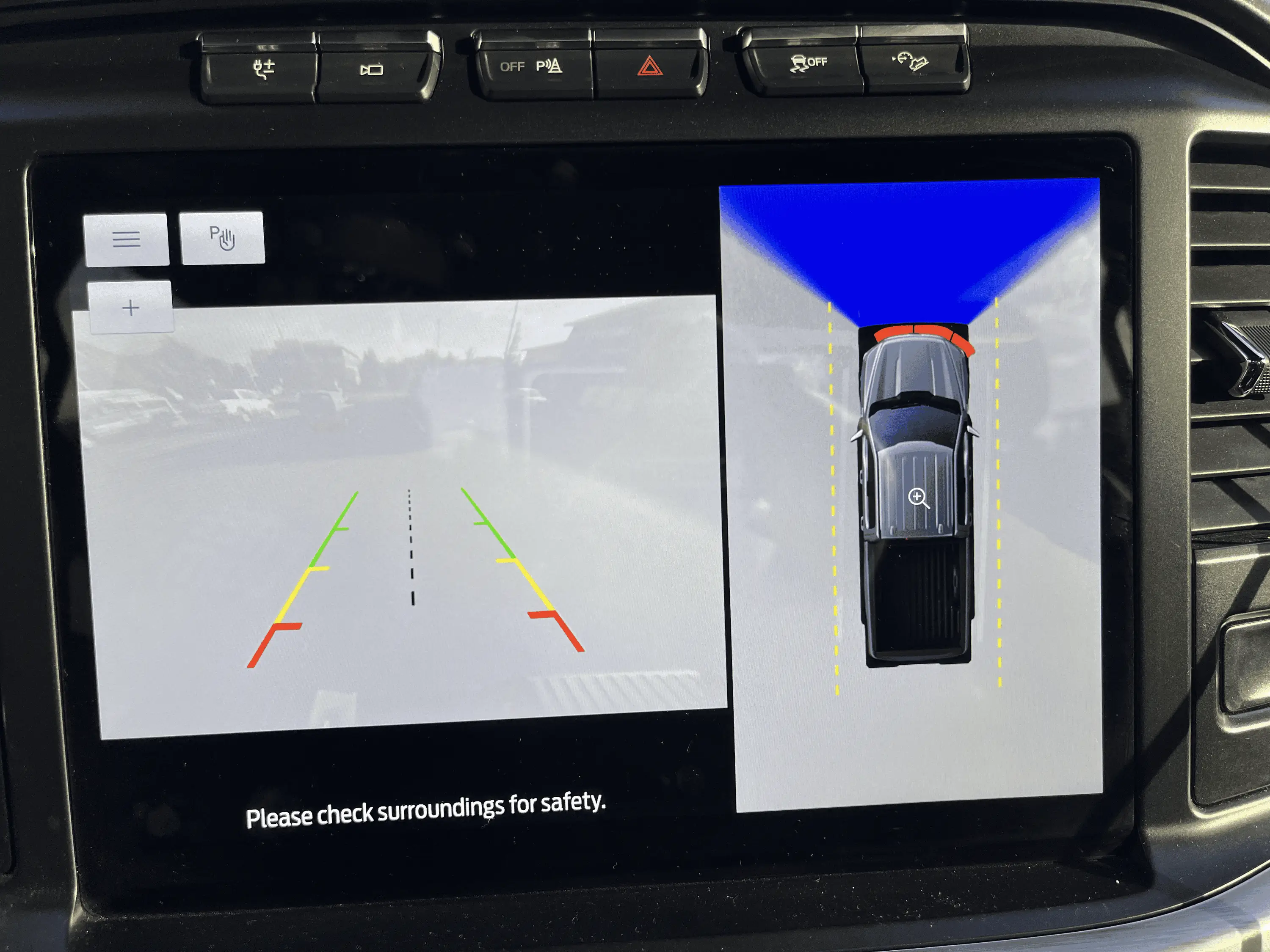

I have 2021 PB, just did my double honk delete via forscan, and had a shop put in AMP research power steps, now my front camera doesn't work, and other camera angles are greyed out (see pic). Timing could be coincidence, but feeling like it isn't. Wondering if doing a FDRS based update could help?

You need to verify the cam is plugged in. The camera connection is near the hood release. Next the the hose for the spray nozzle. That’s a no image error

Thanks Jesse. The connector looked fine, but the little mesh protector was pulled down, so feels like someone has unplugged/plugged before.
I pulled it apart, and reconnected, no joy, issue persists
BTW: is that an optical cable?

It’s coax. You may have a bad camera. The reason for the other cams being white is that front camera signal missing.
once it is corrected the other cams will look fine

Sounds like you feel it's not likely a SW related issue. I'll let the dealer have a look then. Thank you!

That issue is 100% not software related. Anytime one of the 4 cameras is disconnected the rest turn white. Its easy when one is blue ot know where to look because that one has no picture. So they need to verify from the front to the IPMA.
There is nothing software would fix wiht what is in the picture. That being said I still suggest you updating the truck. It makes improvements
