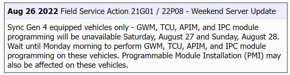

A note for anyone that is wanting to do any programming this weekend
Is it still advised to wait on 2 day license until tomorrow? Was hoping to knock some updates out tonight.
Jesse-Infotainment
They are up as of now. seems to be fine but cant say for certain that you wont run into an issue.
