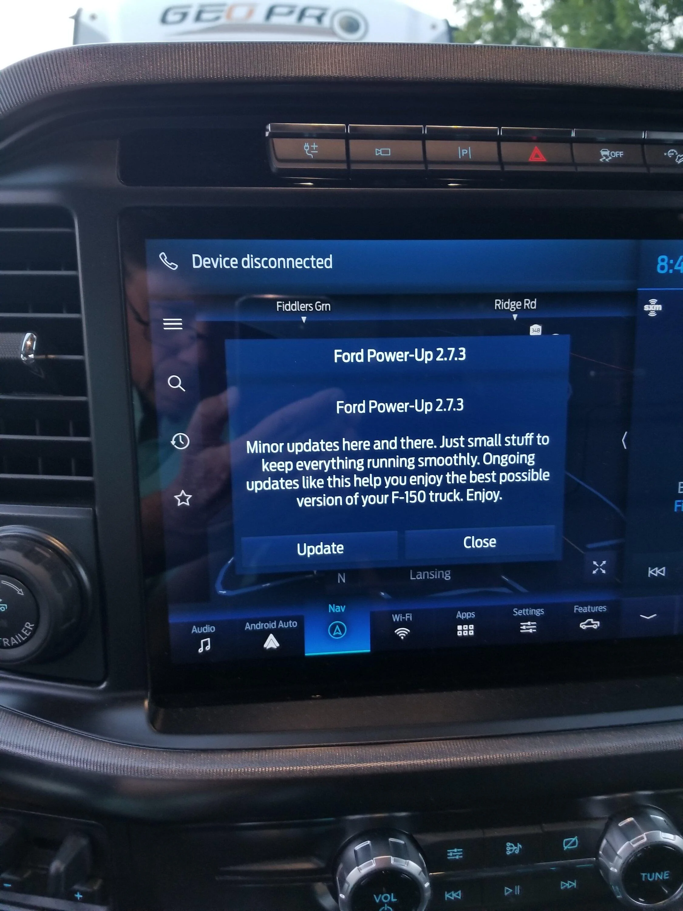

Auto update off, schedule cleared and wifi off but I still get this each time I start truck. Any suggestions?
So to drill down into this a bit...what version of Sync do you have now in your truck (Sync About)?
And would this be a normal progression of OTAs for your truck or is this out of the ordinary/out of sequence? Some people have been offered OTAs recently that would actually take them back to previous software versions (if they had allowed the update to proceed).
This version you're being offered is several versions before BlueCruise functionality comes into effect. Can I assume you do not have BlueCruise at this point?
I am trying to prevent it from installing an old update. I already have bluecruise
I was just about to ask that.
Welcome to the club. You're now something like the 5th person who has posted this issue.
Yeah I would not install that update. It will eventually timeout and fail.
I would however, contact your service department and ask them to pull up your VIN in the OTA dashboard in PTS and report this issue through their channels.

I have this version ? Has this updated already downloaded but not installed yet ,? How long before it times out and how to make it stop popping up each time I start the truck
I don't remember what the timeout period is. I just heard from a forum member on the MME forums that this OTA revision thing was supposed to have been fixed. It is possible that this OTA for you was still in queue and has just not run out the clock yet.
I would just continue to close it instead of updating. It will eventually fail and stop.
After my OTA software downgrade was queued up and I turned off auto updates, I was getting some odd screen pop ups. They went away after I rebooted sync (press radio power and fast forward at the same time). Try that if you haven’t already. Double check that auto updates are still turned off after the sync reboot.
