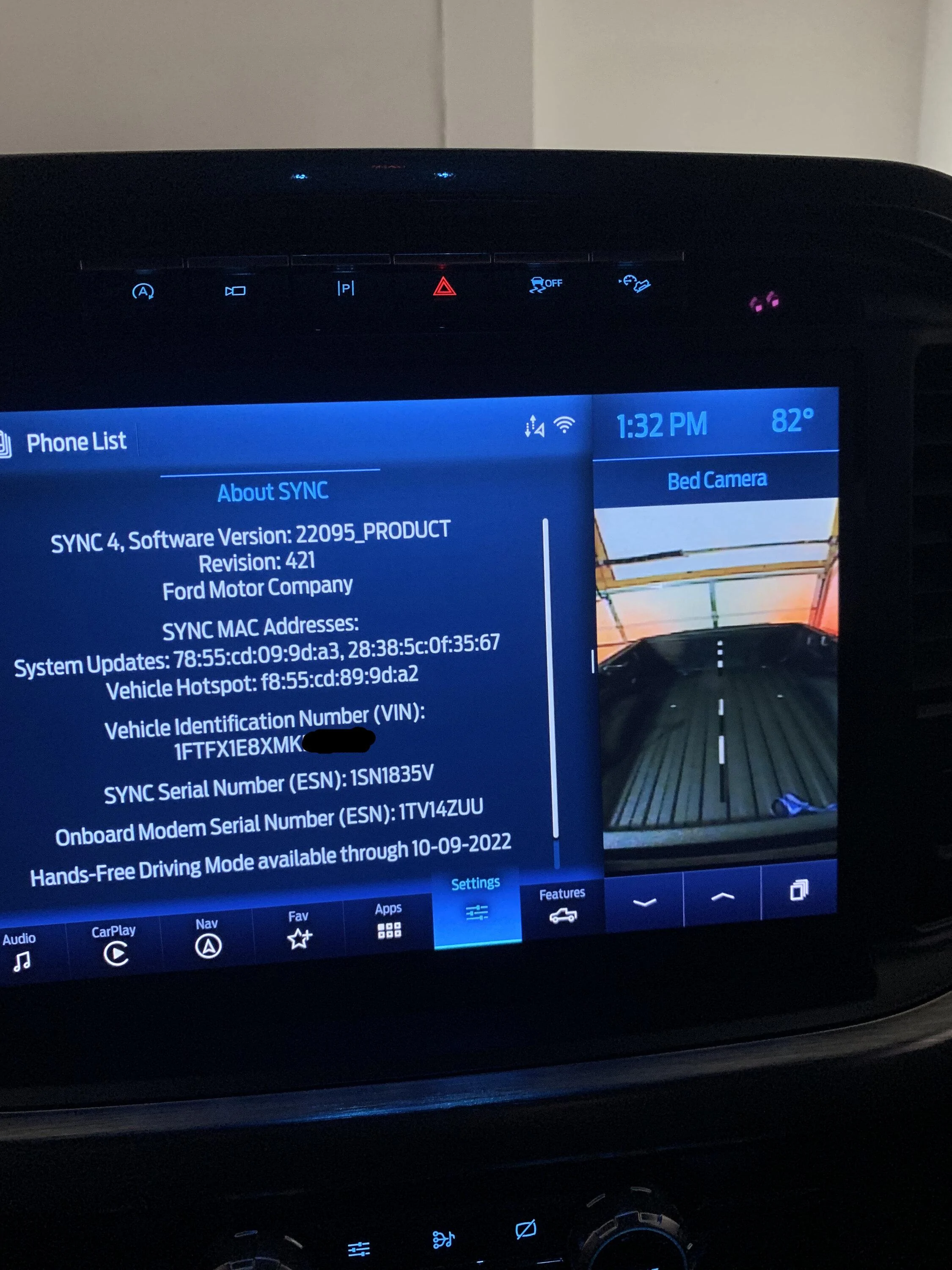

Thanks, I'm at 22087 rev. 415. I just went and double checked the truck, No side card for cameras in motion. Any ideas? I can get in there with forscan if needed.
Not sure why you don't have the bed camera in the side card. My '21 job 1 got that when the dealer got me to rev 364. I'm at 421 now via OTA updates. Now the bed camera is available while in motion from the side card or the main screen. I think it's better from the side card. It's distracting to me when displayed on the main screen while in motion.
