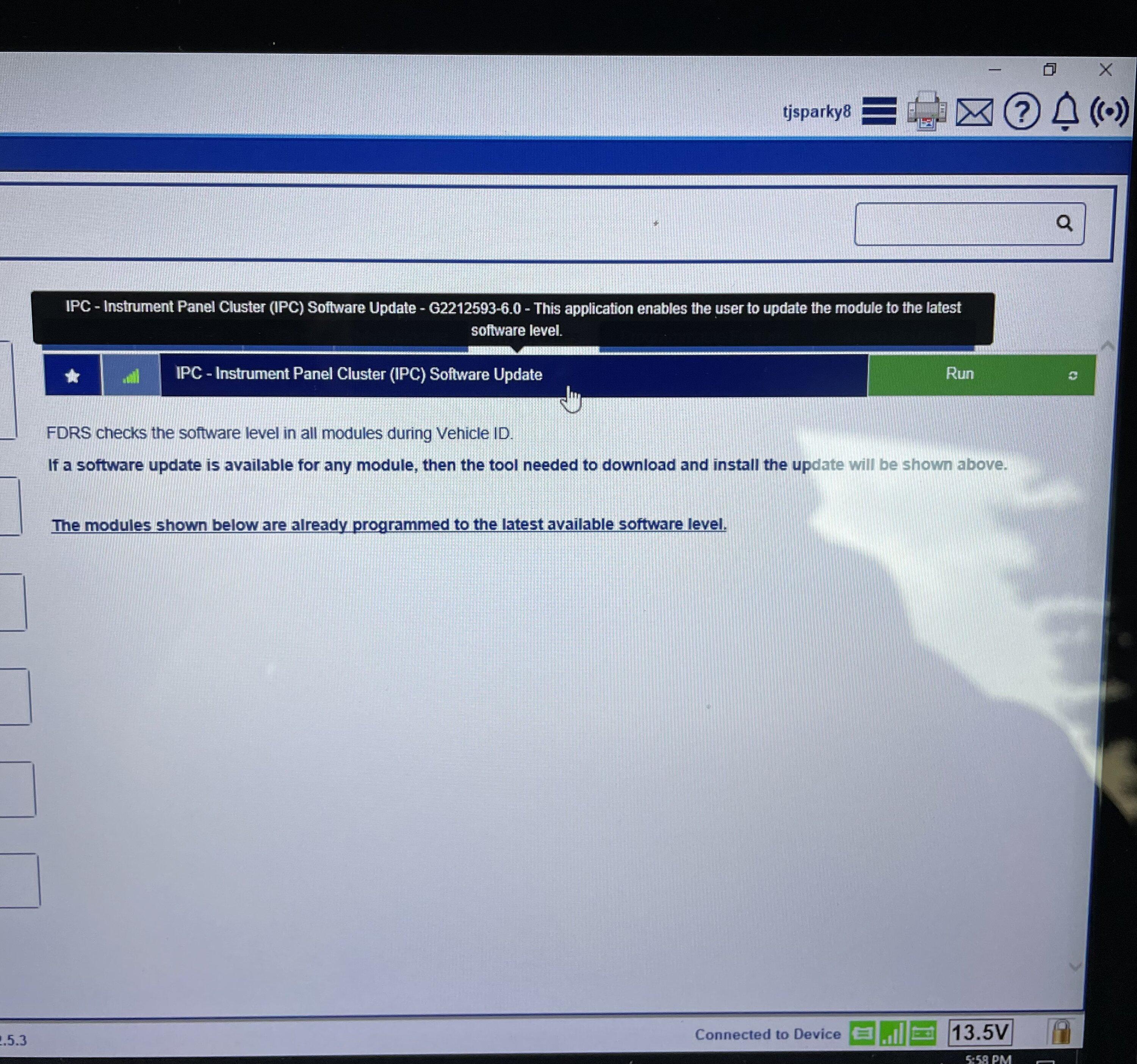

I just went into FDRS and see there is a new IPC update.
2021 F150 XLT 302a with 8” cluster 5.0L

Get the beers ready Gents… it’s another 3 hour + IPC update. I’ll post the before and after versions for my truck when it’s done.

Here is the IPC before update….

I just checked FDRS for the VINs of my '21 Job 1 Powerboost I traded last week and the '22 Lightning I have now, neither of those are affected by this IPC update. Both are Lariats with tech.
Aren't both of those trucks the 12" screen?

I have the tech package with 12” sync screen as well.
You have an XLT with an 8” instrument cluster. An IPC update for the 8” cluster wouldn’t apply to the larger instrument clusters on higher trimlines, even if you had the same sized 12” Sync screen. Sync is updated via APIM updates.
I checked FDRS and no IPC update for my Lariat as of late last night.

12" productivity screen.
Right. The instrument clusters are very different. On Lariat and above, the instrument clusters (productivity screens) are all digital. On XLs and XLTs they are a combination of analog and digital. They look very different under the hood, too. For example, IPCs for the 8” cluster have a calibration software loaded into node F124. The 12” digital instrument clusters on Lariats and above have no node F124 at all.
