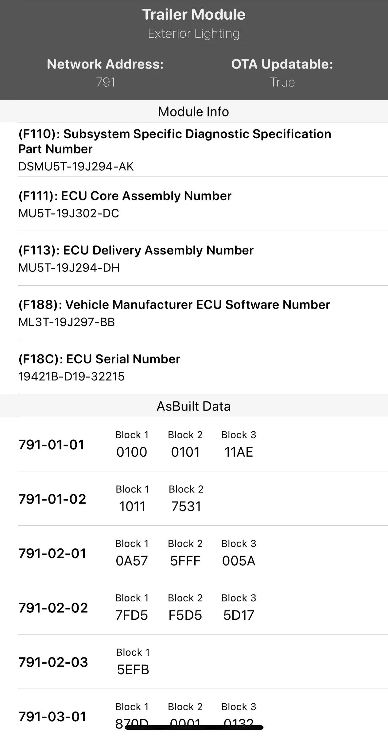

Here’s mine.
Here’s mine after applying the update released on Sunday.
<NODEID>
791
<F110>DSMU5T-19J294-AK</F110>
<F111>MU5T-19J302-DC</F111>
<F113>MU5T-19J294-DG</F113>
<F188>ML3T-19J297-BB</F188>
<F18C>03521B-D18-12219</F18C>
</NODEID>
Looks to me like Ford is standardizing the software across hardware revisions. Your hardware revision is slightly newer than mine, but now we have the same software.

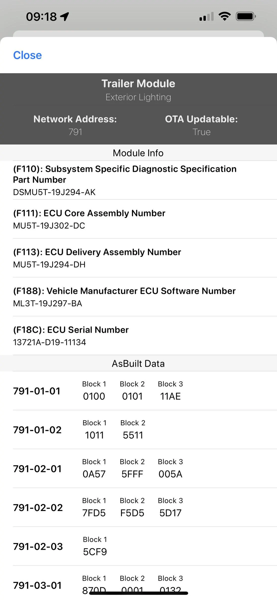

As an FDRS newbie I am totally confused about what these software update P/N's mean and what should stand with regard to the recall update.
Yesterday I updated to the new BB TRM module firmware. ML3T-19J297-BB is what showed up in FDRS after I applied the new update and did a new network scan.
Ford F-150 ECU module programming guide using FDRS bb updat
After the update I went to the Ford widget and did a refresh and this is what the widget says. F188 is showing up as ML3T-19J297-BA, while F113 is showing up as MU5T-19J294-DH.
So is F113 the target for the recall update?
No. F188 is ordinarily the target, particularly for modules that don’t have calibration nodes, like the TRM. Although it is possible for a hardware version (e.g., F113) to change with an update, it would be very unusual. That’s why when you said you saw more than one node update with the latest TRM release, I was intrigued. Your data, however, shows that this was a very ordinary update with software that has been out there for awhile and there was nothing particularly unusual about it. False alarm.
It does appear that your as-built is taking awhile to update, however. Mine updated right away, so I’m not sure what’s going on with yours. If you want to send me your VIN, I’m happy to take a look.

OK, so does F188 in the widget map to the Software Part Number in FDRS? If so why do I have BA in the widget and BB in FDRS?
The difference is @tonesto7 ’s widget reads the as-built data from Motorcraft Service and FDRS reports directly from the module. They should be the same, but for some reason the former hasn’t updated yet.
Two things to do. First, rerun the network scan in FDRS, if you still have access and can connect to your car. That should refresh the as-built on Motorcraft Service. Second, click the TRM module on the vehicle identification page. Module data should appear at the bottom in small type. Look for F188. It should be -BB.

Yes. Several times. The last refreshed time stamp for the for the widget was this morning. Update applied 24 hours ago.
One last thing. Which refresh are you talking about? There is the general refresh for the widget data. There is also a separate refresh/download for the module data. Did you both? If you were not prompted for and did not reenter the three character captcha code, then you did not update the module data in the widget and that might be the problem.
To reload the module data in the widget, go to advanced info, module info, then click “reload data” in the upper right corner. You’ll be prompted to reenter the captcha code. Then the data should reload.

You nailed it. I did not do the second refresh. Now everything squares up.
From FDRS:
Ford F-150 ECU module programming guide using FDRS fdrs Trm
From the widget:
Ford F-150 ECU module programming guide using FDRS IMG_2907507401EF-1
