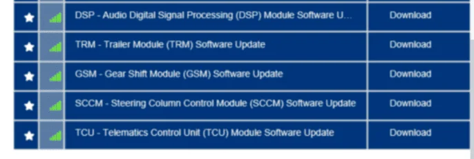

Ford F-150 ECU module programming guide using FDRS 1651609096987
Ford F-150 ECU module programming guide using FDRS 1651609092187
