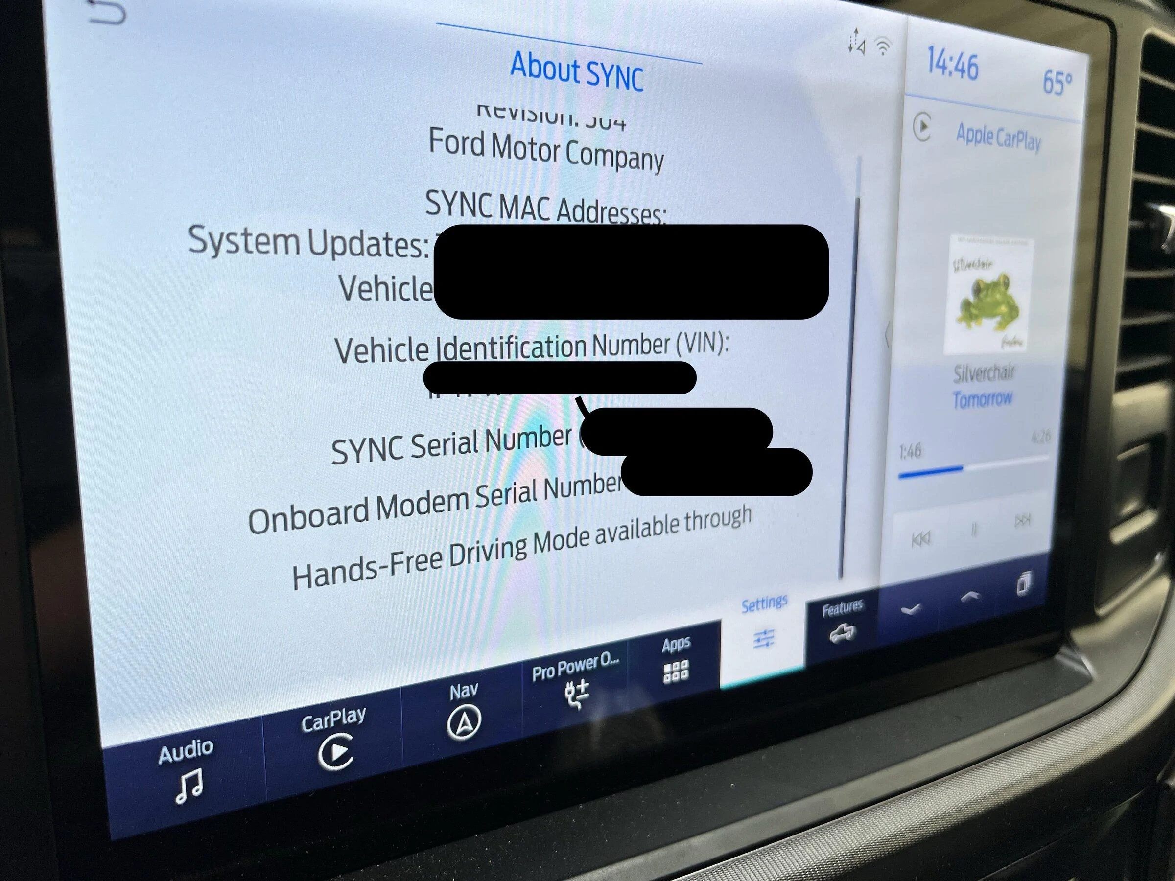

Edit/Update:
This is what my "about" menu shows and maybe explains why I got BC without any notifications. I'm going to go ahead an assume that the blank date means I get BC "until the end of time" after going through this song and dance!
Ford F-150 ECU module programming guide using FDRS IMG_0470
It turned green on my final scan and I'm now 100% up to date! Oddly enough, my Blue Cruise says "Activation Pending" on the Ford connected services page, and I've received no emails or anything and didn't see anything unusual in the menus so I took it out for a test drive and figured I'd see if the lane keeping assist had improved.
I hit the button and suddenly the dash lit up and I was officially Blue Cruising!
I need to try the ForScan updates for cameras at speed since that's not working, and as someone above mentioned, my PRB up/down works fine but the approach detection either isn't as sensitive or isn't working.
Before they were frankly too sensitive and whenever I'd lock the truck they'd stow and then immediately re-deploy since I was still near the truck.
Overall super happy this all worked, and really appreciate all the gurus sharing their wisdom!

Check on your web dashboard and make sure its not pending for 600 bux and really shows one year free. Check your about screen in your truck, make sure the last line also matches a one year free date...
