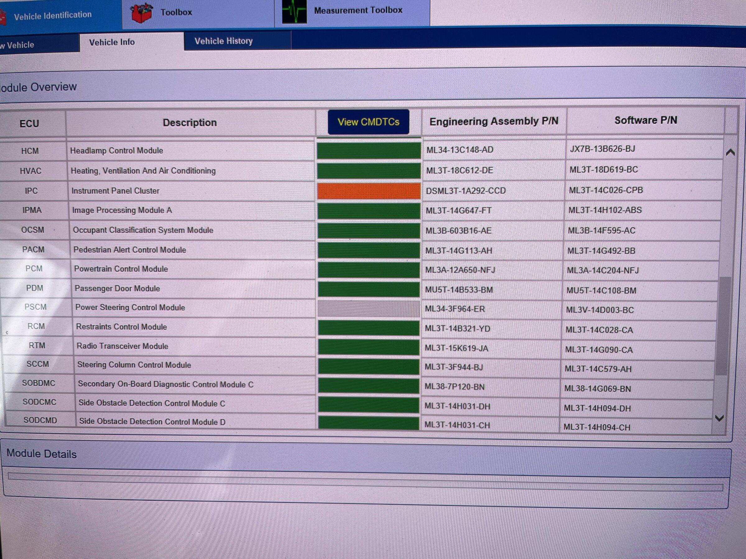

i answered my own stupid question, I can see the data in FDRS, it is corrupted there as well.
Am I destined for a dealer trip? How the hell do I fix a corrupted module?
That's not a corrupted module, you have a DTC. Can you provide us the DTC it's showing?
The DTC is U2100, no initial config. The reason I think it is corrupted is because the Part number is wrong.
If the USB update had gone through and not the CAN update I would have
F120: ML3T-14C026-CRC
F188: ML3T-14C026-CPC
If the Can update had gone through and the USB then I would have
F120: MU5T-10F906-FDA
F188: MU5T-10F906-FCA
But what I have is
F120: MU5T-10F906-FDA (USB and CAN Updates Went Through)
F188: ML3T-14C026-CPB (This looks like the USB went through but corrupted the code from CPC to CPB, and then CAN never went through).

I see what you are saying, but it's been almost 96 hours since my IPC CAN failed and I still can't PMI it or clear the DTC.
But what I have is
F188: Ml3T-14C026-CPB (This looks like the USB went through but corrupted the code from CPC to CPB, and then CAN never went through).
And as I said to @Skier167 you as well as he will have to fail the update and go the CANBus route
Also, have you made any IPC FORScan changes and if so, which ones?

@Bob_Mac yes I made changes for adaptive headlights to the two below
720-01-01. 22FOA 3064 F4EA
720-10-01. 0B18 0061 00BC

Did you pull the USB stick out first? Or did you mean the update no longer appears in the SW tab?
It no longer appears in the software tab, the only thing I have is the GSM procedure. The update failed, but it still cleared itself out and I can't get back in.
