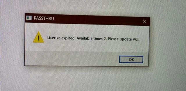

Got everything except 2 modules that I updated but keep coming back. Apim required a usb. Did that and it said it was up to date and was happy....Also got this weird lil popup saying passthru expire, etc.... Drove me nuts.
That Passthru error is weird. I’ve never seen it before. Maybe Iceman or Jesse can shed some light on that. My guess is that there might be some kind of renewal/validation that needs to be done in VX Manager, not FDRS.
Sounds like everything else went ok. The ABS and GSM updates never seem to go away despite multiple tries. They didn’t for me or Snakebitten. So, that would appear to be normal.

The popup didnt seem to stop anything. My malwarebyes was more of a pita... Had to add vxdiag to exclusions. That might stop the popup. Manager said all licenses were good so.
I also have a couple days access to the Ford service info site. So it was a $75 day. Just wish there were someway to determine that actual ots firmware numbers, like 1.7.1, etc. Not sure what ota Im on. Never got a notification and the diag says its still waiting from Nov 2021. Wonder if that will ever flip.
I got the passthru pop-up out of nowhere too. It was the VX software and I just closed everything and reopened the VX package and everything was normal again. I never saw the pop-up again.
Love the success stories!
OTA is a great idea and perhaps Ford will figure it out and improve on the delivery. But until then we CAN do something about it. :)
Ah, that might be why I never saw that Passthru pop-up. I used VX Manager to load the drivers and make sure the firmware on the programmer was up to date. But once I did that, I shut VX Manager down and just used FDRS because FDRS recognized VXDIAG directly. At least, that’s what I remember from two weeks ago.
