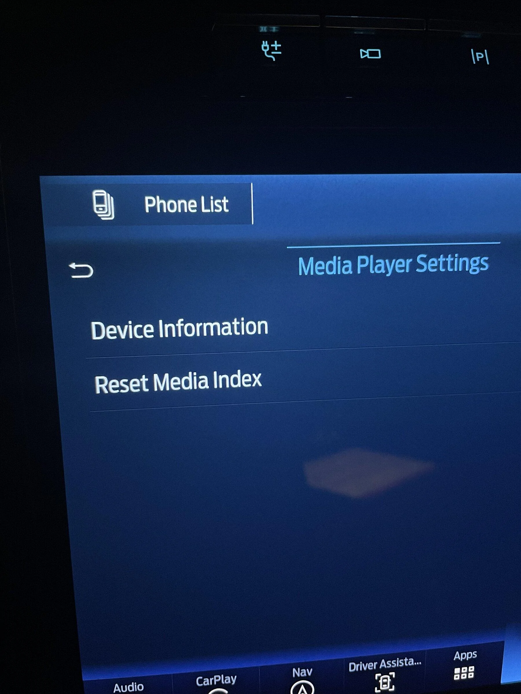

Discovered something today while trying to do my updates. No need to do a Master reset to get the usb to re-index. Go to Settings>Media Player> Reset Media Index. Upon removing the usb the system will delete all info from the usb and it will initiate indexing the next time you insert it. Do all this while it is still inserted in the media hub
