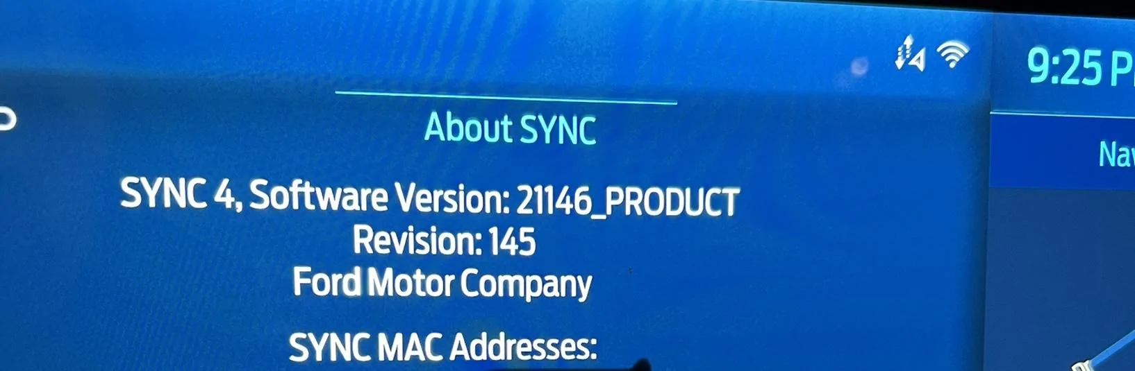

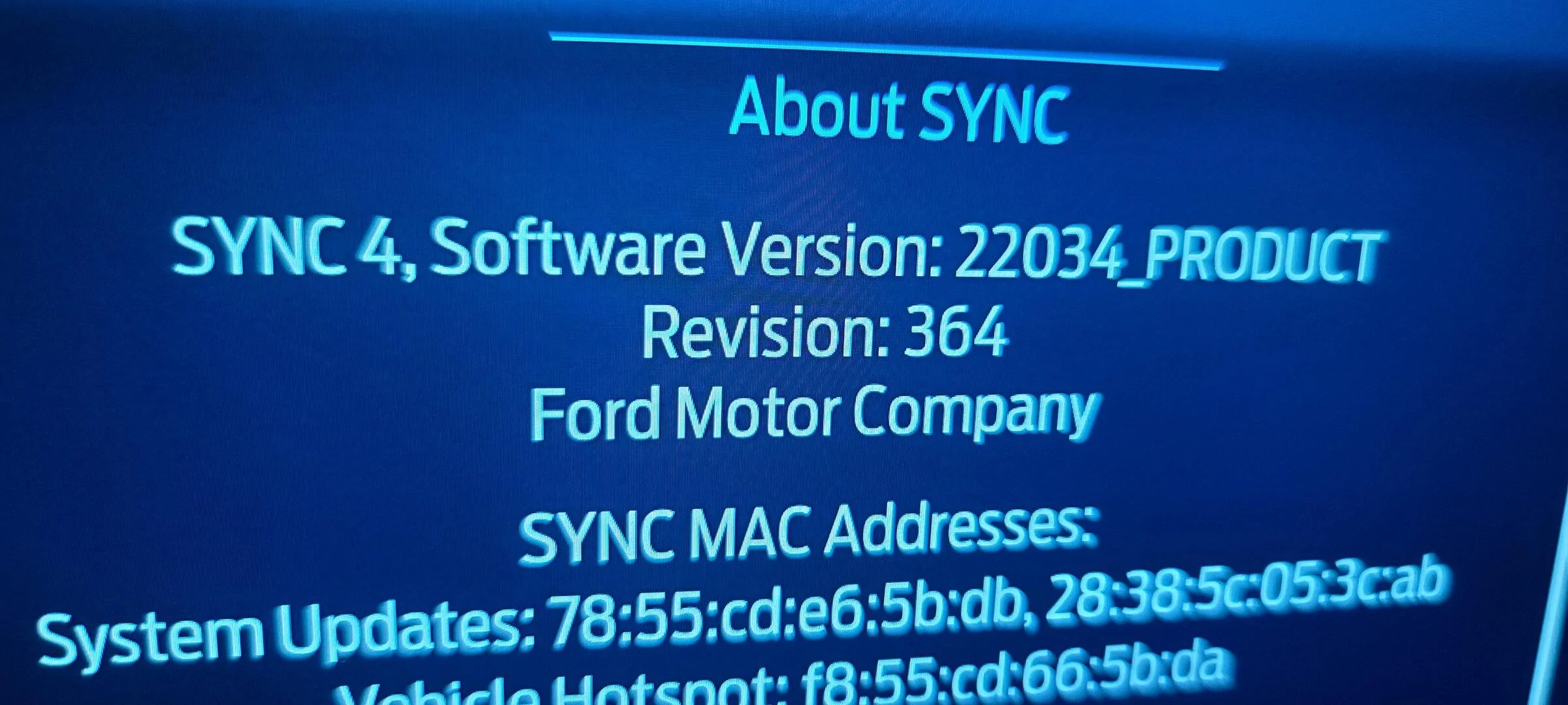

I’m only getting this Sync version after my APMI update. Should I expect another APMI update to appear for a later version?
I have a Job 2 truck with Sync 4.0.21136. It doesn't show any APIM updates for me either and I have applied all updates. I'm not sure if something is wrong or if there isn't an update for my APIM hardware. I also haven't seen a GWM update, either.
mine is Job 1, so that could determine the version level to. Who knows..
