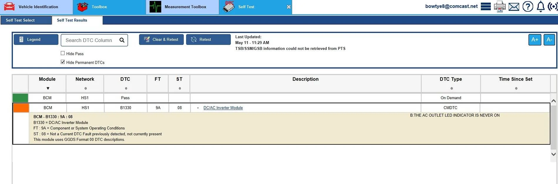

Thanks again all for the support! All updated. well except BCM. I saw it cant. Well are folks joining the NASTF? Just reread . Thats a paid service.
I did get a BCM code for my AC convertor. dont remeber using it. but I have seen post where the fail often.

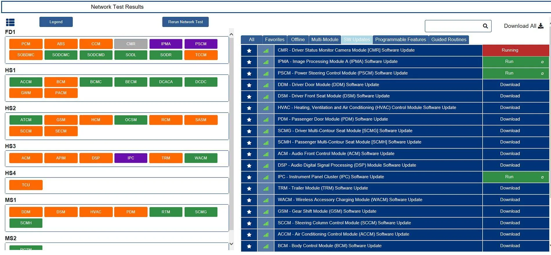

Ok, I need some serious help. Long story short, I have a '21 that I updated to get blue cruise several years ago. Since then I've received 1-2 OTAs annually, but pretty minimal.
Later this week I'm taking my kiddo to college and decided I should get ready for that road trip and check and see if I had any updates. I had lots and figured I would dust off the Mongoose/power supply and get those knocked out this weekend. Now I have a truck with no instrument panel or power steering. Help!
At this point I just need to get the truck back driveable so I can take the kid to college.
I had several failed modules that failed at the same spots repeatedly so I started writing them down:
  • IPC failed at F188 NU5T-10F906-FCC (step 336 of 449)
  • CMR failed
  • PSCM failed at F188 ML3V-14D003-BD (Step 13 of 385)
I'm going to get a few hours of sleep and renew my FDRS license in the morning. Let me know if you have any advice on how I should tackle this. Here is my latest Toolbox view:
Ford F-150 ECU module programming guide using FDRS 1747634925601-8z

CMR is failing on F188 ML3T-3G604-XL
All of the above start with F188, is there any significance in that?

Did something happen mid-update, like the laptop going to sleep or the battery on the truck dying? Or did the update just fail with no other explanation? Background might help in offering better advice.

I was having an issue with one of my USB ports and it lost connectivity to FDRS at one point until I changed to a different port.

@JJ_Tex Ok just saw your screenshot. IPMA, PSCM and IPC are bricked. This is going to take some time to fix. You will need to run the PMI of both the IPMA and the IPC and select "no" when FDRS asks if it is the original module. The IPMA will take 3 hours. The IPC may no longer be able to be updated with the USB and you will have to CAN the update in. This will take 6 hours to do. I am not sure how this happened in your case, but you will need to recover those modules via a PMI.
