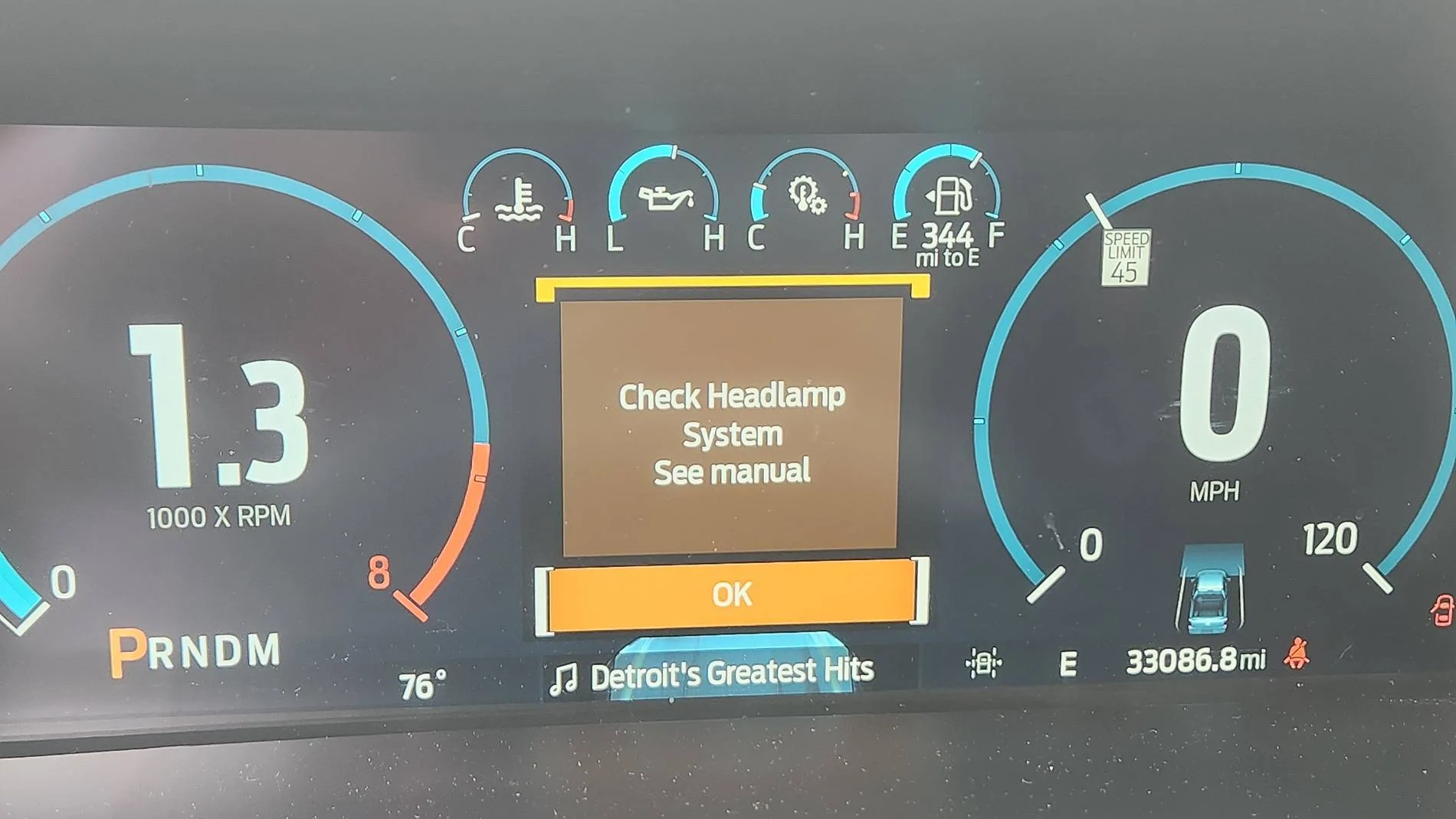

I just took my 2022 F150 Lariat in for the rear axle and DRL recalls. When I got the truck back I am now getting a "Check Headlamp Sysytem" error on the instrument cluster display. I took it back to the dealer and they have now had it for 5 days saying they cannot figure out why this error is coming up. Prior to the update I had absolutely no issues with this. Anyone else experience an issue after the DRL recall update? Oh, they are saying it may be because I have the Fox 2.0 leveling kit on the truck.....

I had a 23 Tremor do that, we had -40 cold up here on Canada when that happened, the cause was the little electric motor that turns the yoke for the adaptive headlights failed, the fix was a new headlight under warranty thank God.
