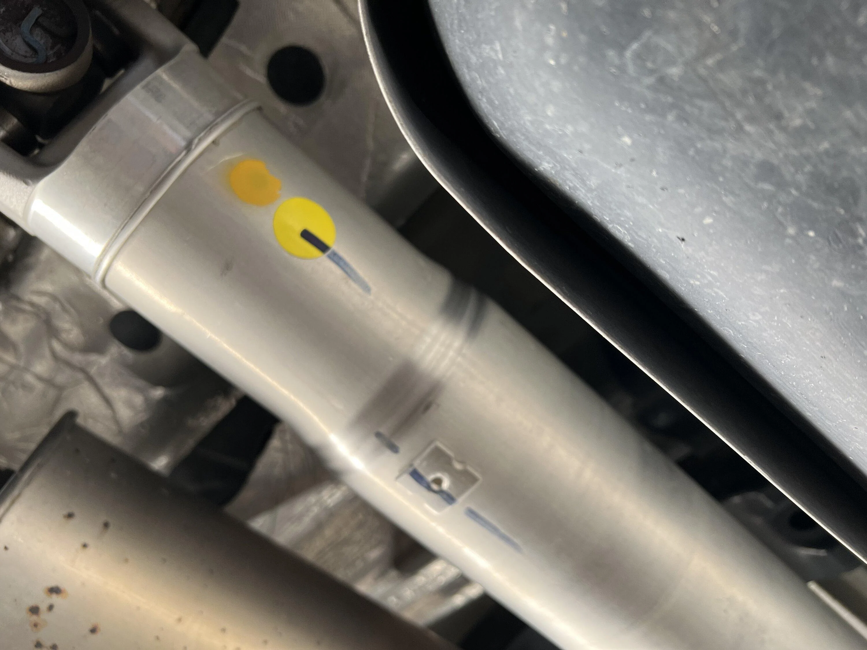

Please take a look at my driveshaft (below), and tell me if this is safe to be driving around (notice the 'pitting' of the aluminum on the right hand side of the groove). This truck is shaking when on the highway, and idles like a 1970s Mack truck... We are supposed to leave on a long-planned (and paid-for) cross country trip with our RV, and I honestly don't feel comfortable - but don't know if it's me overreacting to the driveshaft risk, or is the driveshaft is actually fine (please see the picture)...

Can anyone provide feedback on the photo; is this driveshaft an issue (given the wear mark, I think it is)...

If you put a sharp ruler across it does it dip down into the metal at all or is it more buffed?

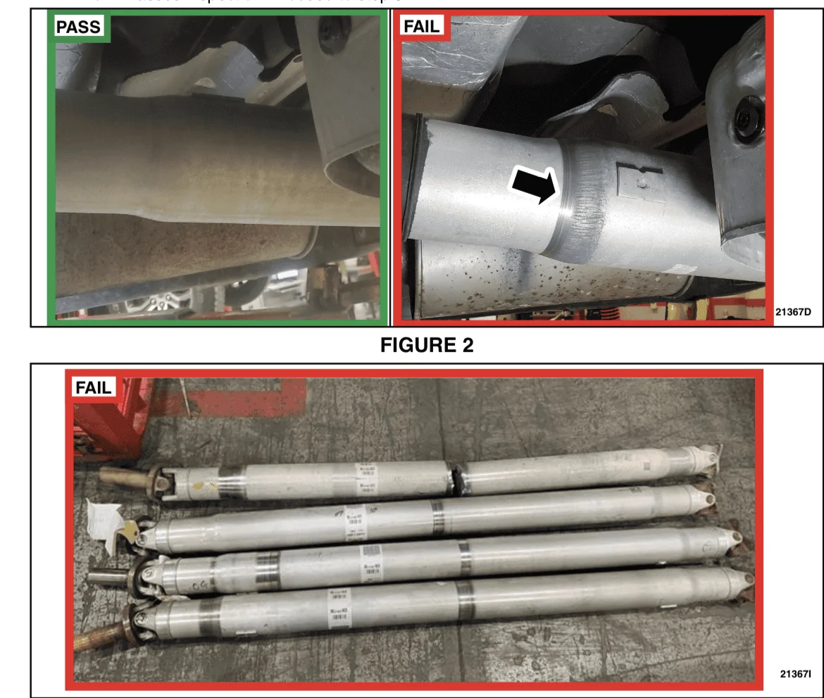

FYI the Ford inspection procedure with pics and description for determining 'acceptable' and 'not acceptable' driveshaft damage is attached.
Methinks that someone made a grave and likely illegal (violation of NHTSA regulations) mistake when they 'closed' the recall on your VIN without having implemented the required remedy but I've no idea or suggestion about how to resolve your convoluted situation in a timely manner.
Good luck.

I would not drive it and get it fixed ASAP. That metal is really thin as shown in this post.
Some images below:
Ford F-150 Driveshaft Issue (with photo) -- HELP 1659460149412

That's what sucks about this recall, it's so subjective to whatever tech is working on it. Mine was deemed "OK" and I was sent on my way.
I would demand dealer #2 fix the problem, as they were the ones who closed the recall without fixing it. You need to get the GM involved of the store, let them know they falsely closed a recall without fixing it, no matter what good intentions they have.
Also here's a pic of my "OK" driveshaft, it was just a polish and I can't feel any grooves. So who really knows if it's "OK".
Ford F-150 Driveshaft Issue (with photo) -- HELP IMG_2136
