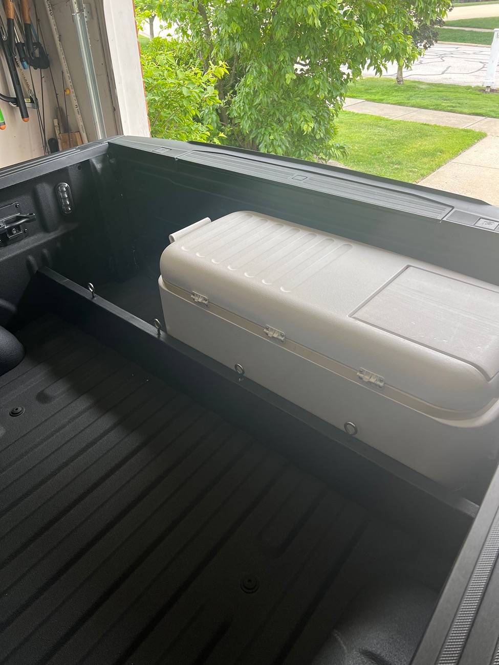

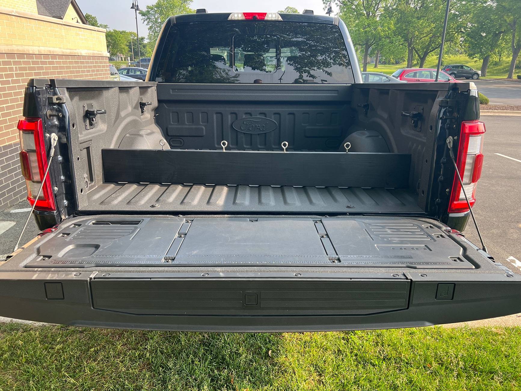

The E-Track board holder is easily removed so you can still use your Ford cleats. While the E-Track cleats fit the Ford boxlink and will not fall out, they are a little loose. To tighten them up I added a small strip plate to my boxlinks to narrow the opening. This helps but means the Ford cleats will no longer fit, so I bought a couple E-Track cleats to use when needed.
If you zoom into the closeup photo below you can see the plate and hardware mounted to the inside of the boxlink.
Where did you source the brass cleats the 2 x 4 is riding in?

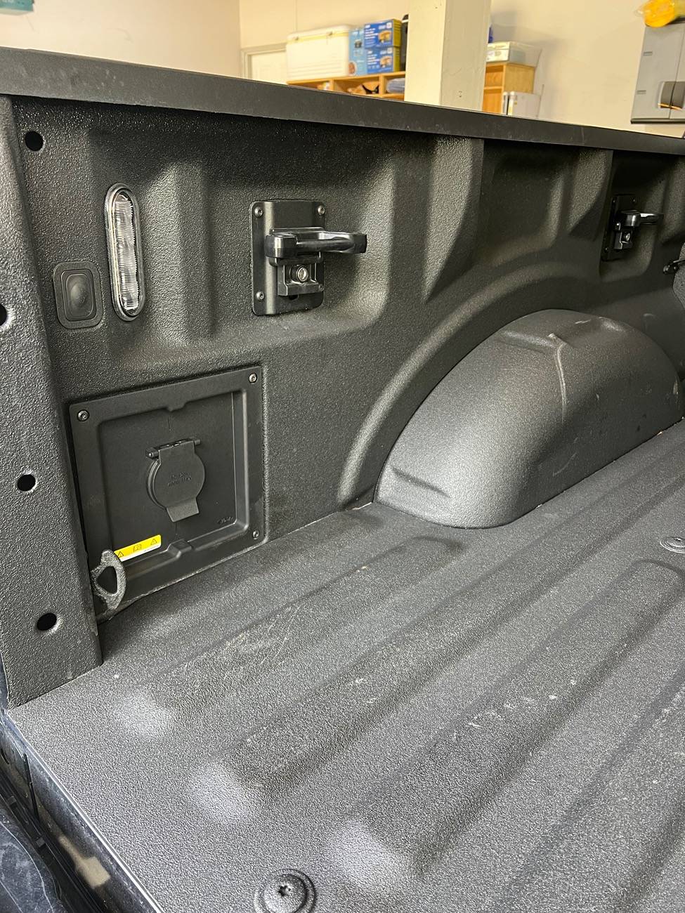

I went simple on this as we were going to pick up a load of stone from a friend that wanted it all removed from their property. I didn’t want any stone sliding around in the back before I’ve even had the first oil change so partitioned the back to minimize movement.
I still need to add a piece that will run perpendicular to the last one, make a space for gas cans so they won’t move while going around the corners.
Ford F-150 DIY Bed Divider IMG_0204
These are simple 2x4s and a 2x6, cut and stained.
