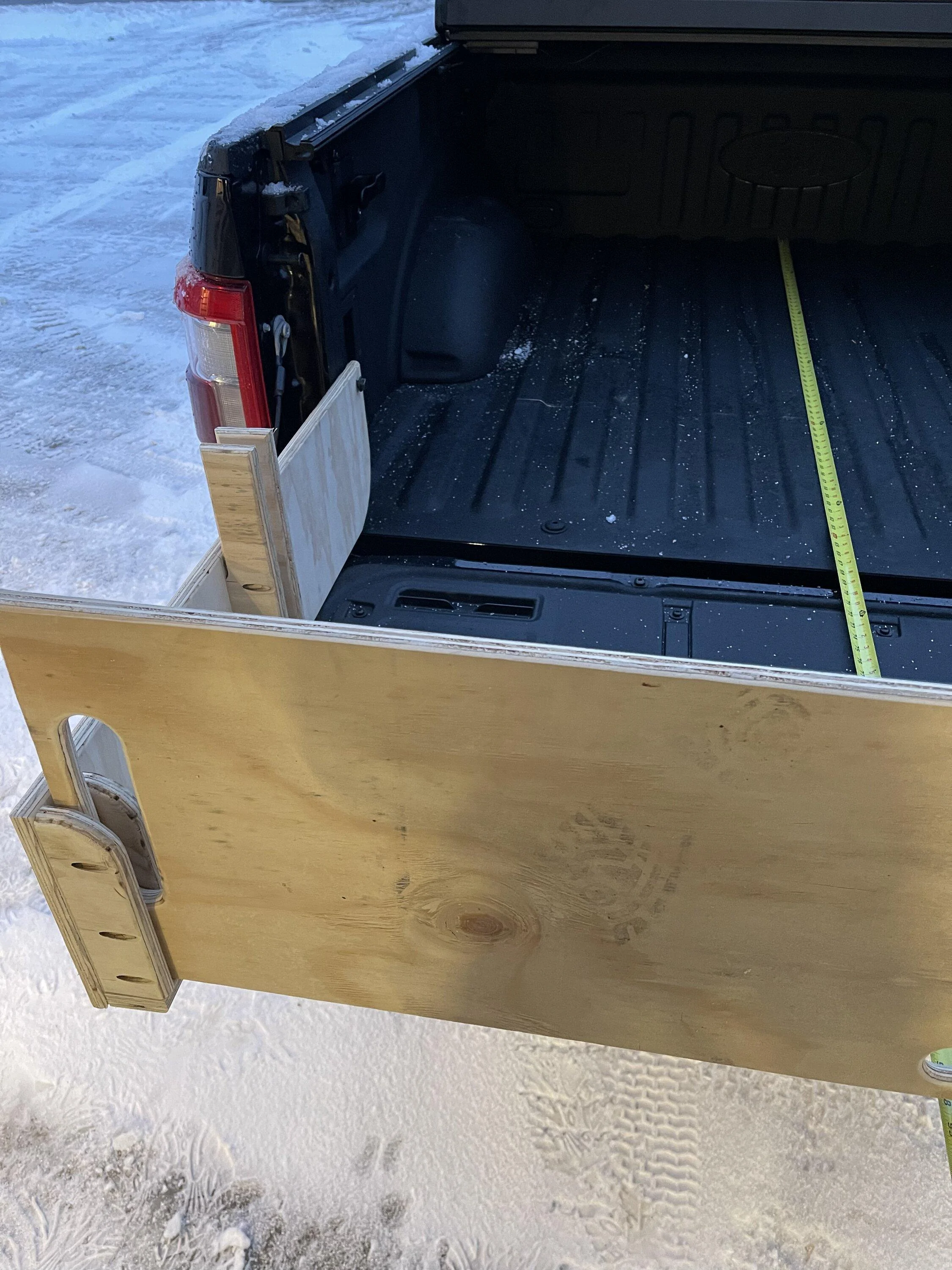

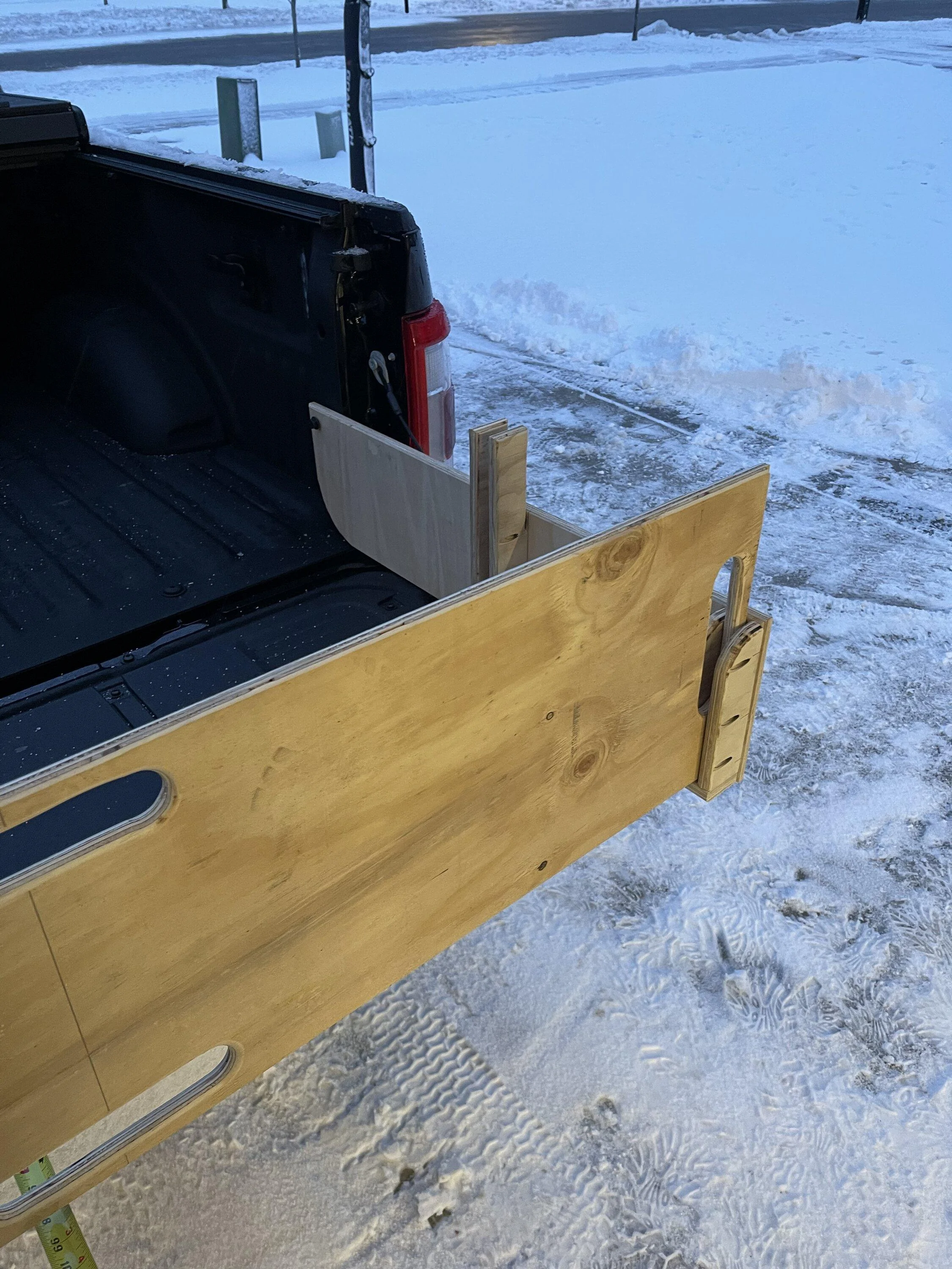

Hi Guys, new here but figured I’d share my latest little project so that I could secure groceries as well as 8’ lumber. This isn’t “done”, just a prototype made out of scraps I had around the shop. It’s all 3/4” ply.

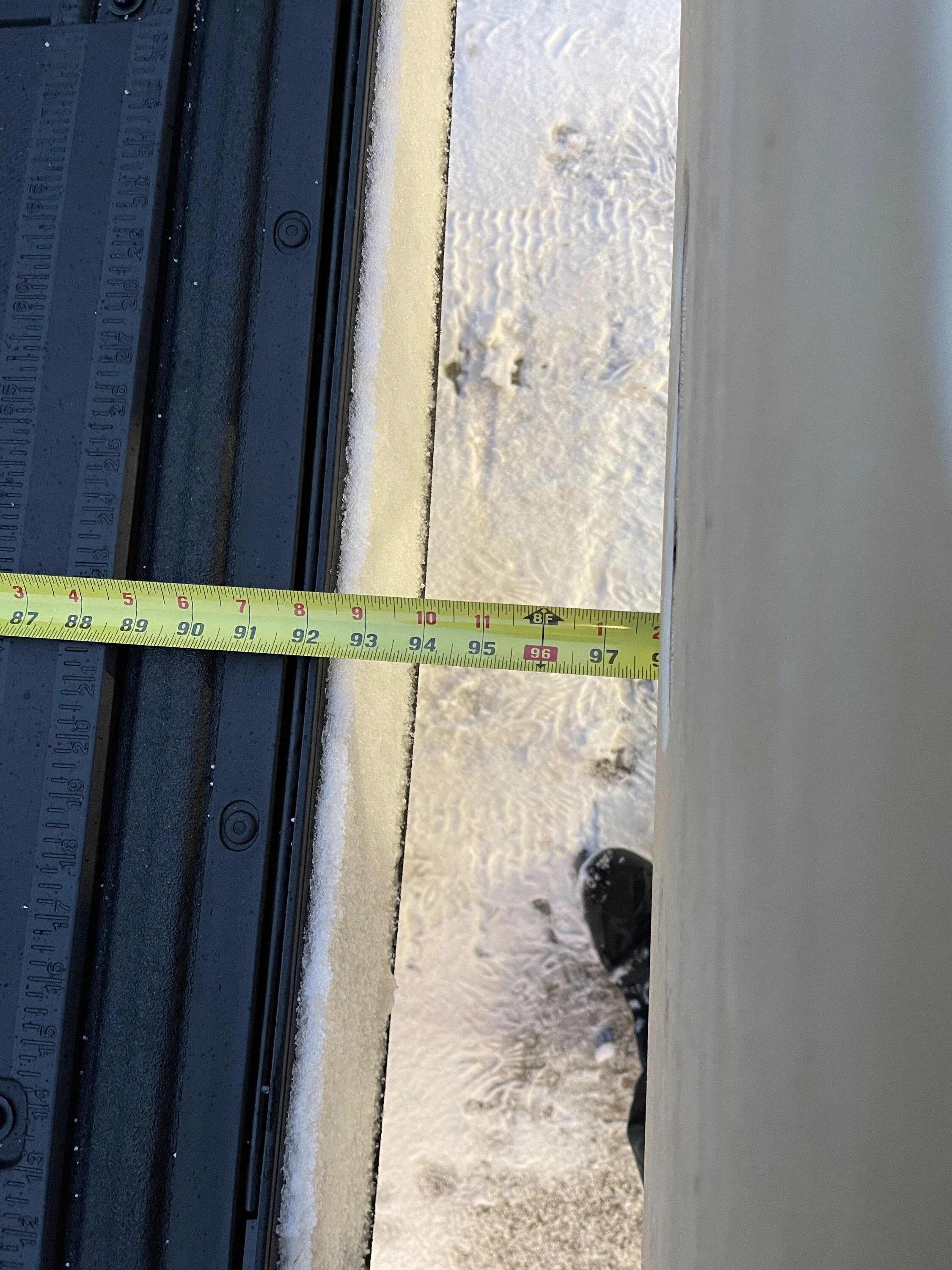

I bought a bag of 6 bolts that fit into the (not so) threaded hole near the tailgate in the back of the truck on Amazon for $15. This lets me make a couple for the neighbors, or make other accessories that use those holes. After some rough measurements inside of my 5.5’ bed I determined that a divider could go roughly 20” in from the tailgate, any more and it interferes with the wheel tubs, and would make it difficult for my wife or kids to reach anything in the bed. I also measured from the front of the bed to a couple inches beyond the open tailgate to get to 8’ total length when extended.

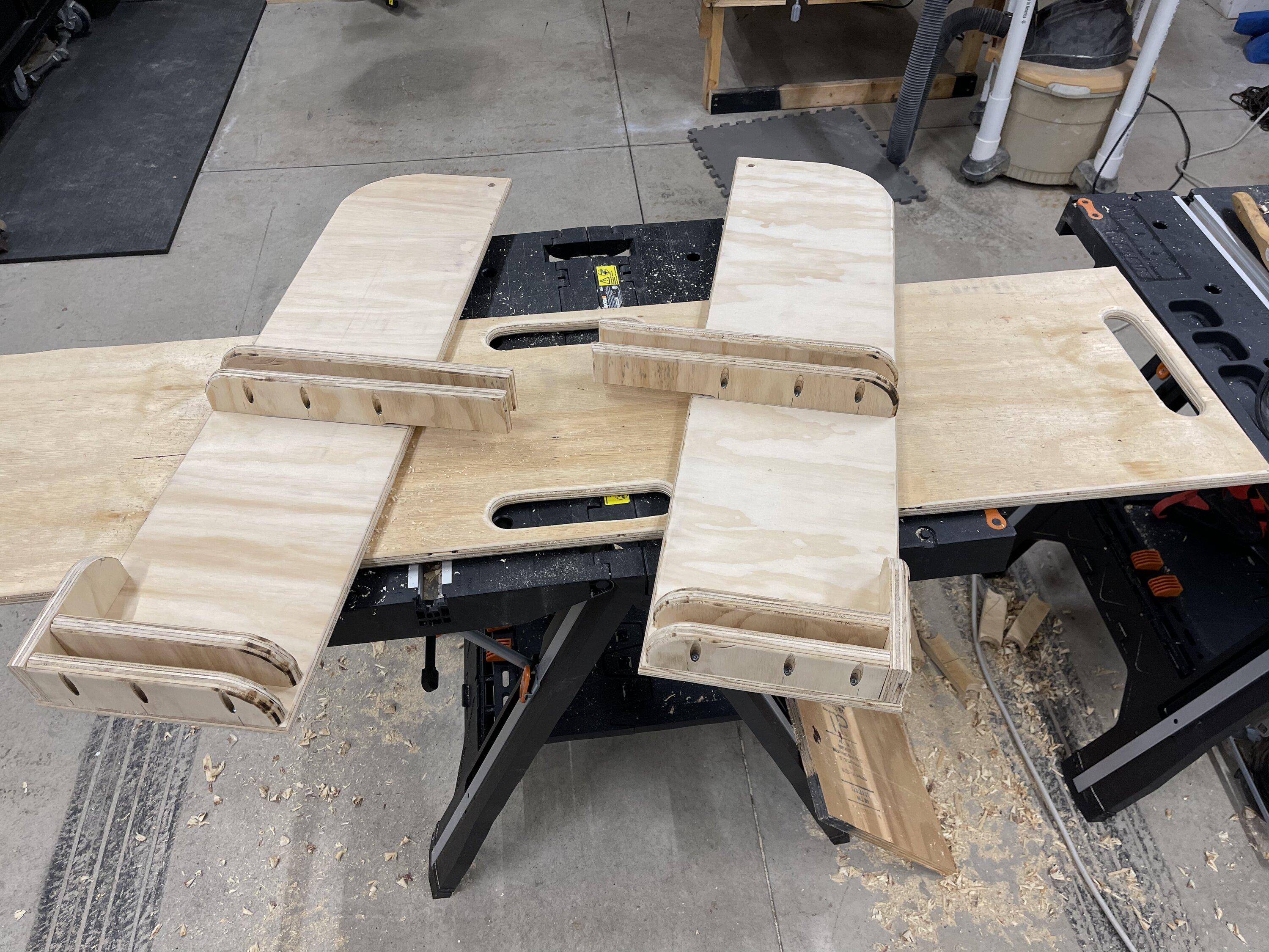

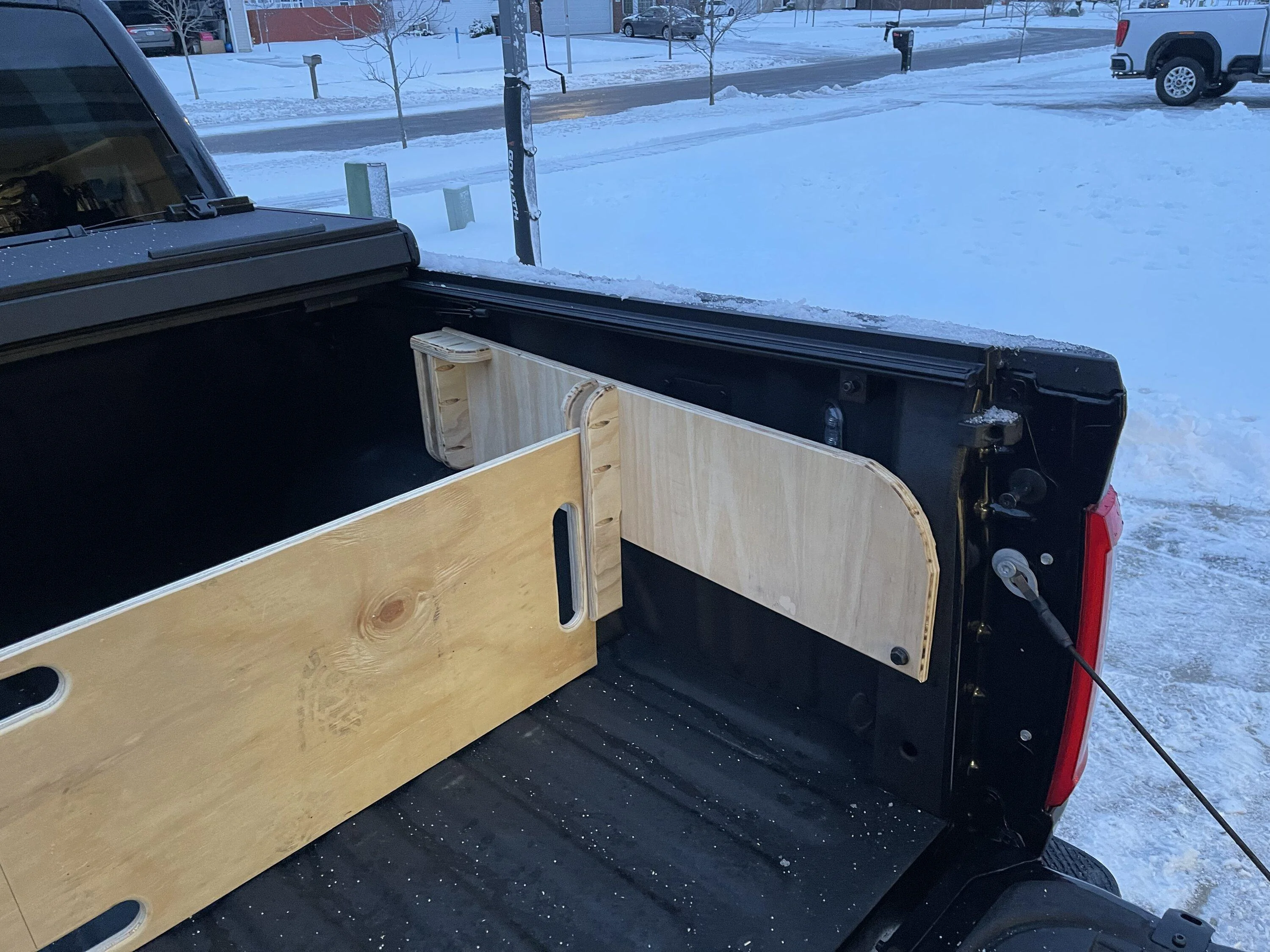

The divider piece (the large panel with the handles) is going to get a bunch of holes cut into it for straps or bungees to tie to. I’m adding a small spacer between the arms and the bed side to make it less “floppy” side to side. When the divider is in place, it stiffens up the whole deal, but I want it more rigid when going from inside the bed to outside.
Because it’s a prototype it’s just pocket-hole screwed together. Glue/screw and paint in the final phase. It all fits nicely under the tonneau cover.
Take note, because the extender extends a couple inches past the tailgate that the panel sits on some additional pieces of wood, or it would fall to the ground.

make sure you secure that end panel down somehow in the extended position, it could easily vibrate up and out of the slats and go flying

Good call @cheesedogf150 - I have a couple holes that need drilling that will allow me to pin that in place. Currently, it can be strapped down. You’re 100% right, that would jump right out of there.

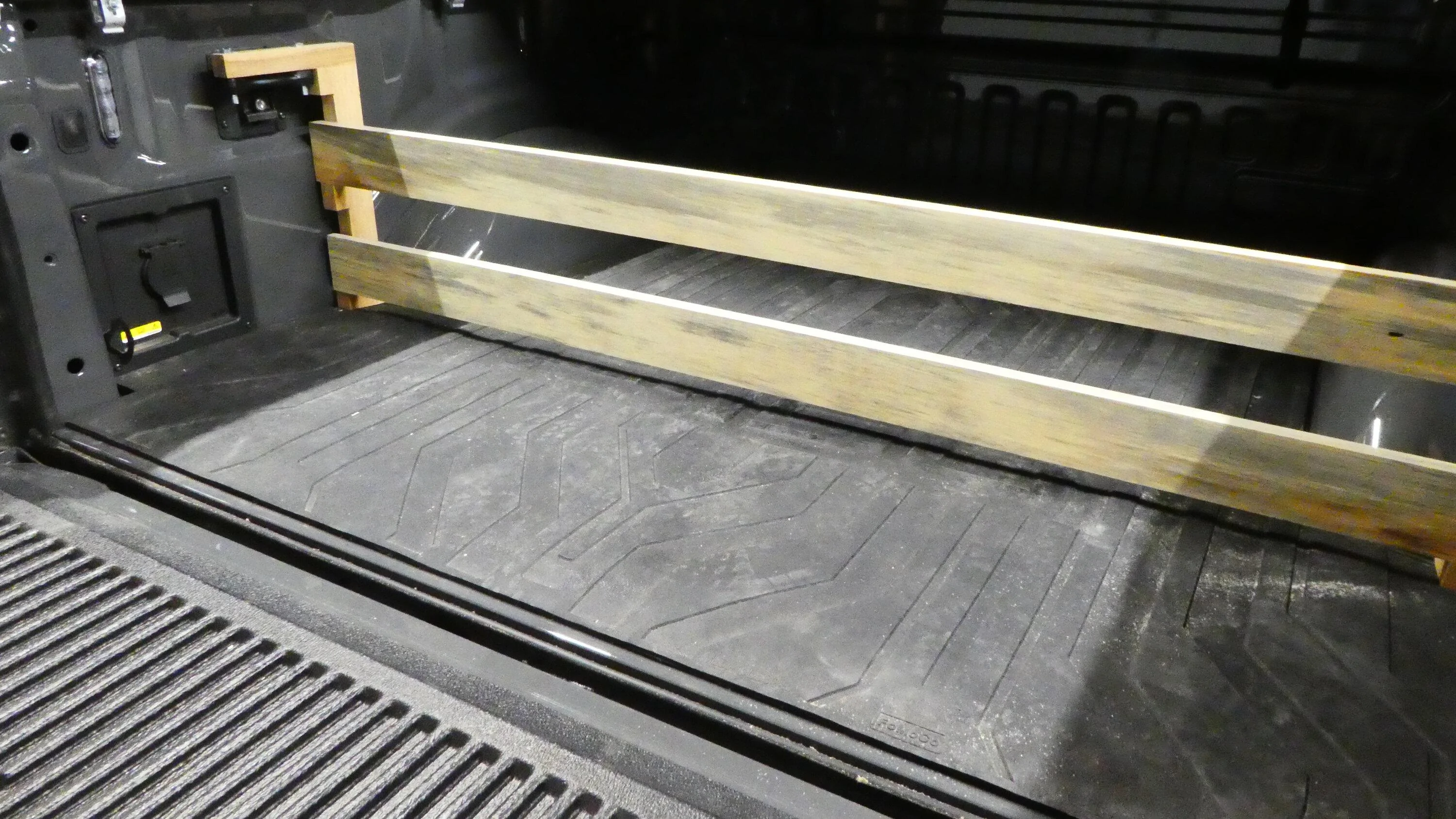

I really can’t stand you handy guys. :( I wish I was this and so does my wife lol ? this looks great. Love the adjustable

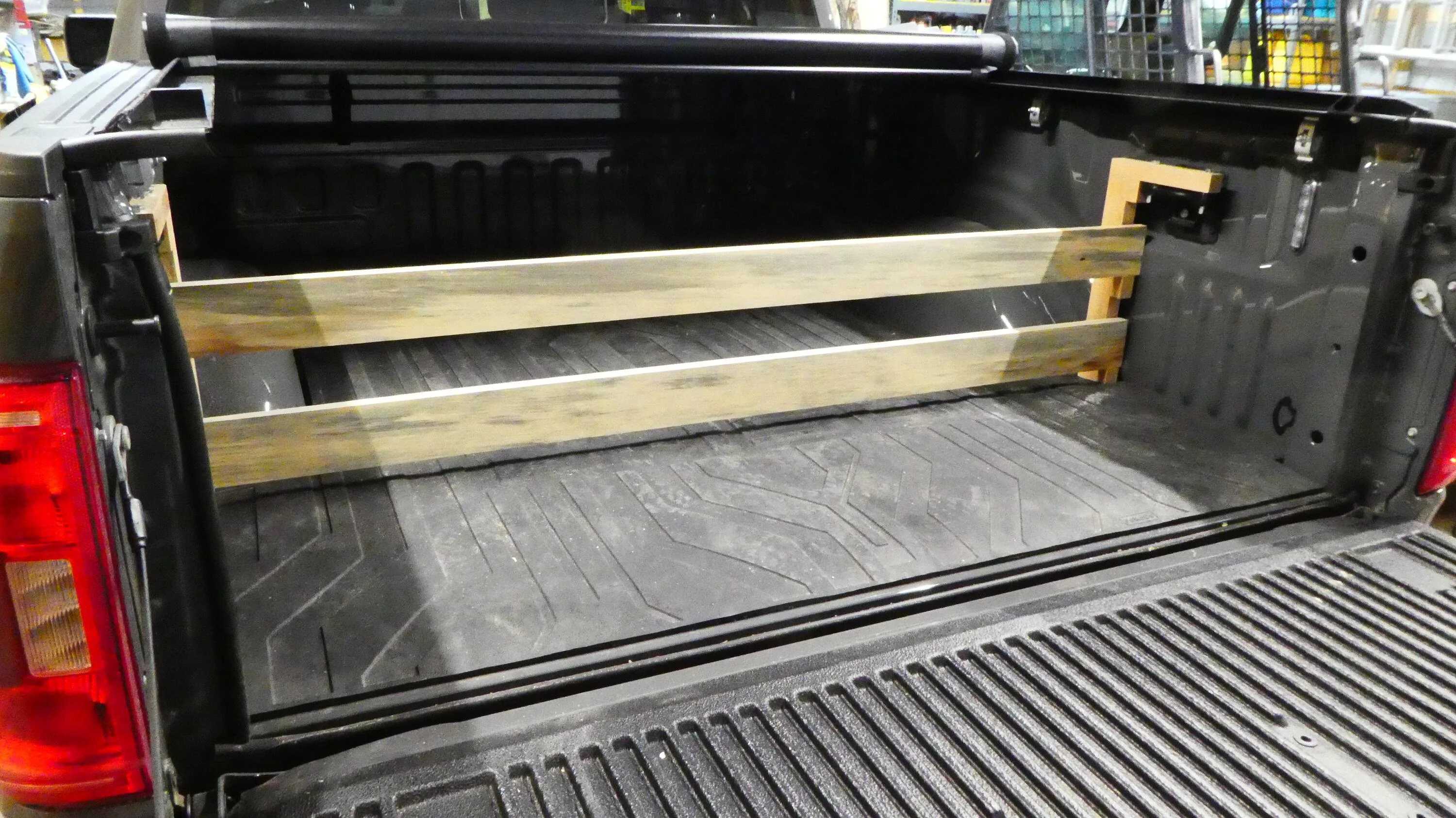

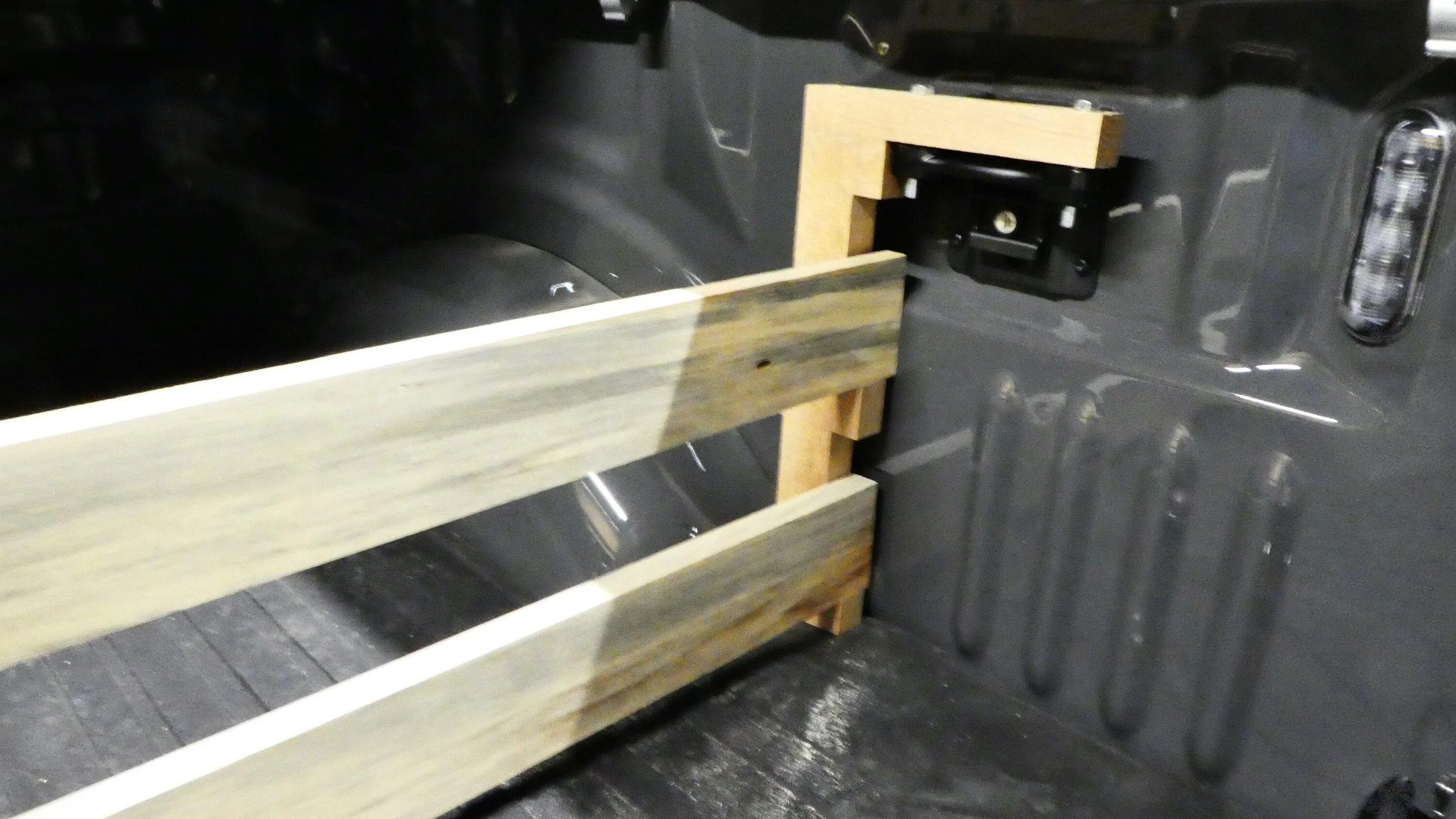

Just for you, I’ll show you v1… which anyone could make in 30 minutes with basic tools.
Ford F-150 DIY - Bed divider & extender 27D13495-BC66-4632-9751-5F1B133595B1
Ford F-150 DIY - Bed divider & extender 5450FFEE-B2B5-4798-AF2D-52D3B7A9C26D

I like how you used the holes in the top of those tie downs. I noticed last night that my tie downs are pretty hard to access with my boards in the way. I’ll cut a relief in them to give me 360* access to them in the next revision.

Very nice DIY. The flip design is clever. (y) It looks heavy though. I suggest skeletonizing it. Plywood is really strong. You can cut most of it away. The divider/extension panel could have screen sandwiched between thinner plywood. I have the Ford divider. It [isn't] structural. It is just a fairly light weight barrier. Your needs may vary though.

Thanks @oneinch, and you’re 100% right. I haven’t hacked away at it yet, but those holes will make it lighter but also give me more tie down and strap options. Just haven’t gotten around to it yet.
Since I take the large divider out before I move anything else, it’s really 3 very easily manageable pieces, but lighter is better.

Making holes in the divider will reduce the weigh in the bed by less than having a gallon less fuel in the tank. Most important to me is knowing that it can prevent something heavy, like a tool box, from coming forward and through the rear window in an accident or emergency braking situation.

Not worried about the weight in the bed, it’s the weight of the thing my bad back needs to pick up and negotiate in the bed.
