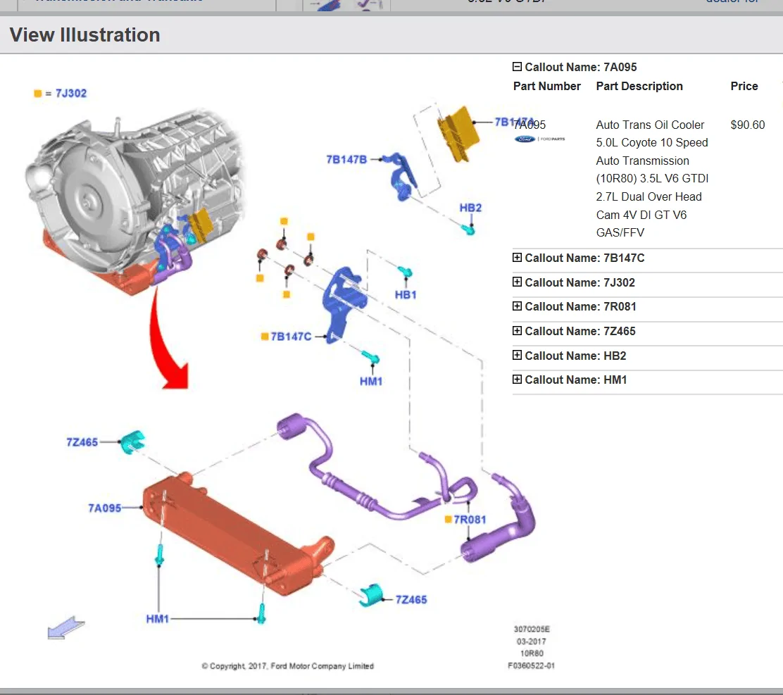

Yes sir. When I was under trying g to get the darn plug out I saw there was as no cooler. I was expecting to see one as all of the videos show having to remove it for the pan drop. I’ll post a pick or two when I put my skid plate back on.
I believe the cooler is mounted up on the side of the transmission.
Ford relocated it from underneath the bell housing in 2021
Press 2021

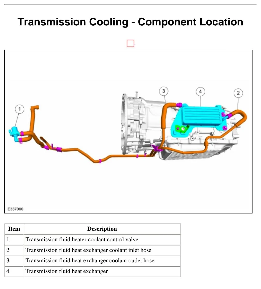

Ford F-150 Dip stick plug - why Ford? transcool (1)
Current location
Ford F-150 Dip stick plug - why Ford? Screenshot_20230725_073456_OneDriv

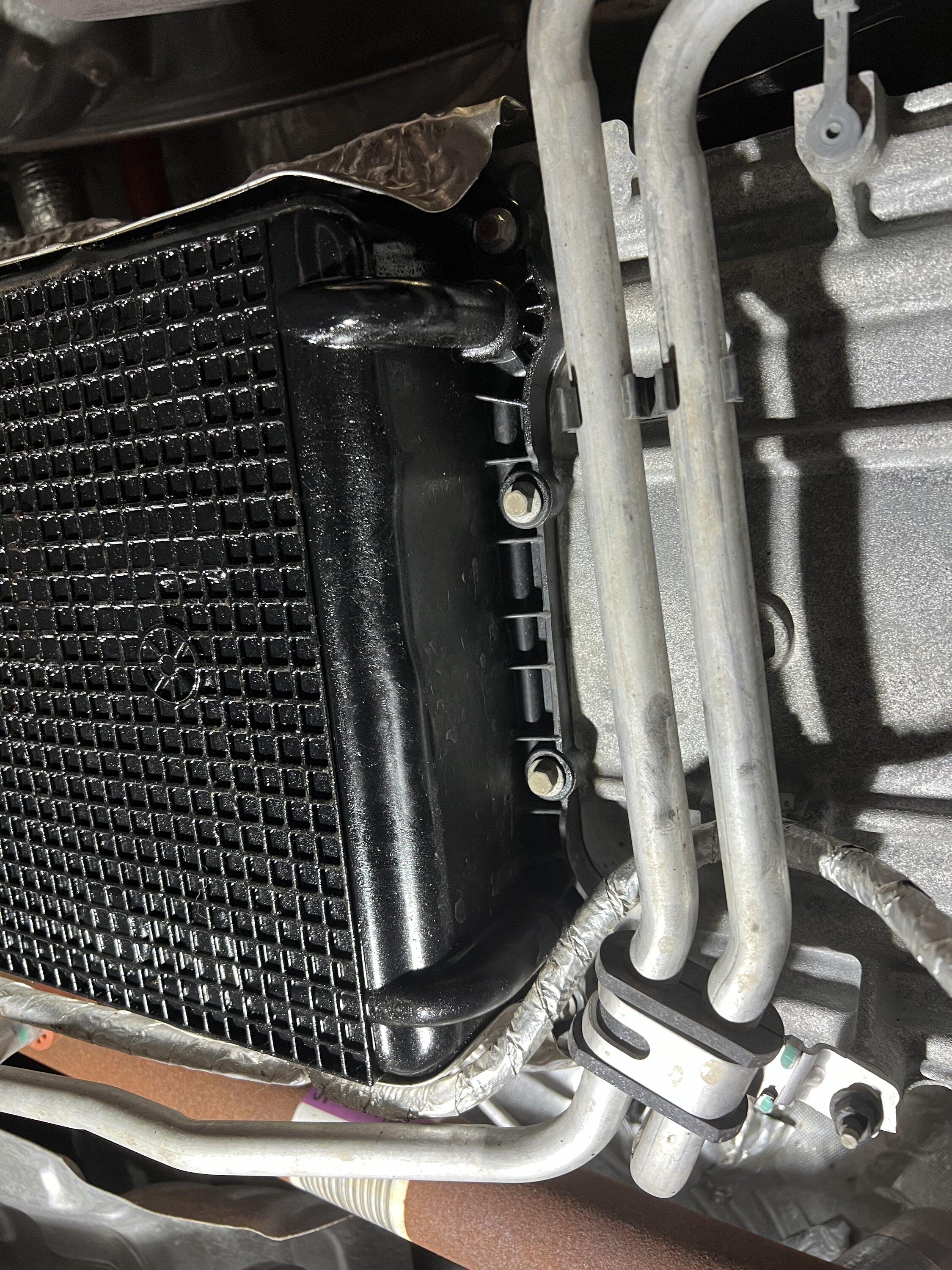

Ford F-150 Dip stick plug - why Ford? IMG_0857
here is a pick looking forward.

Press 2021
Current location
I was expecting to see what you show in the first diagram. Given the heat exchanger (second diagram) I do wonder if it drains under gravity?
what I thought were lines for trans fluid to move forward are coolant lines for the fluid to water heat exchanger.
