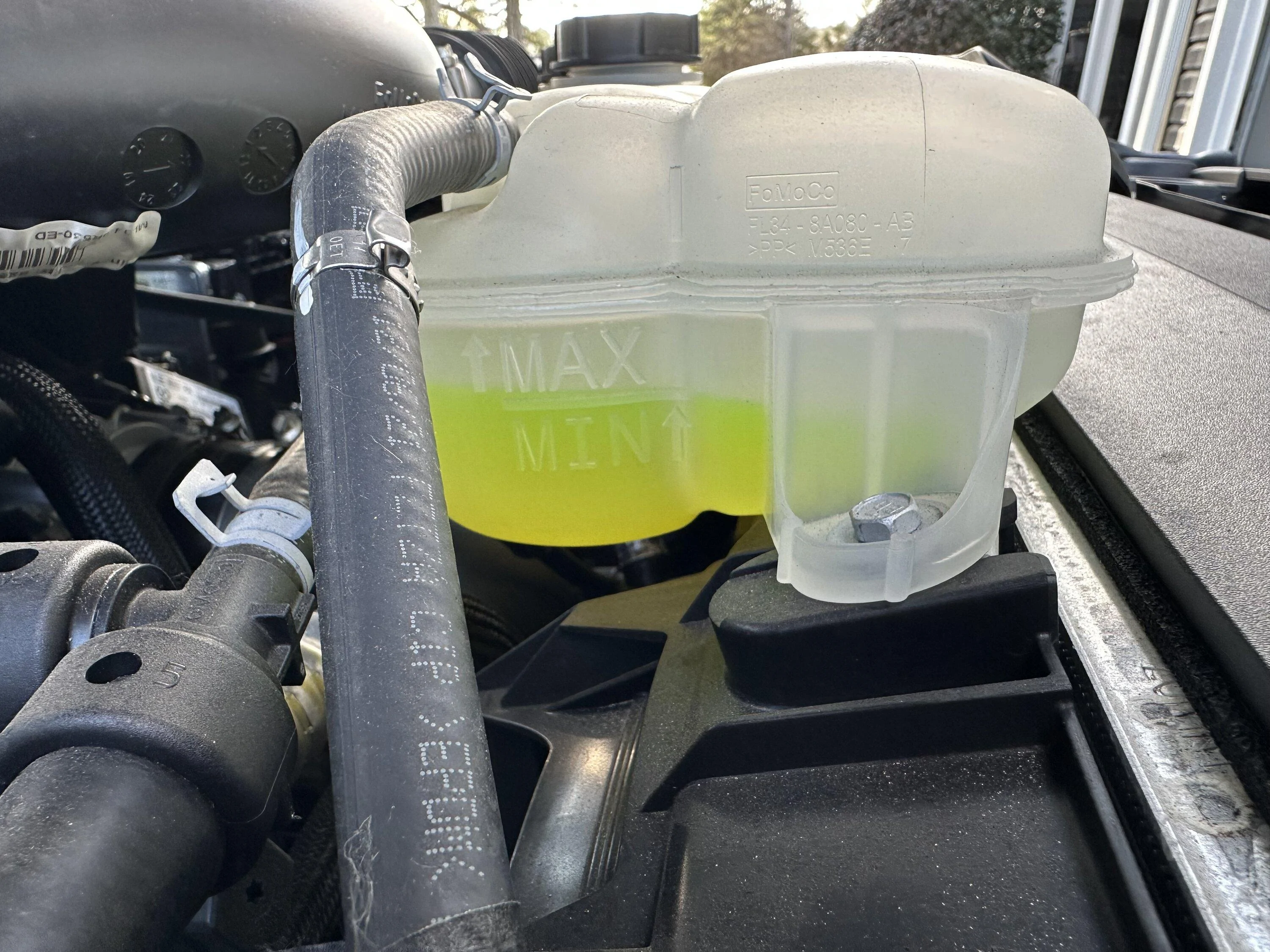

I took my Powerboost in to the dealership because the coolant was low. I also let them know that the coolant was darker than normal and smelled different. They pressure tested the system and didn't find any leaks. I realized after picking it up that they didn't top up the coolant. I took it back immediately to have them top off the coolant (the foreman topped it off with Ford yellow coolant). It has been about 1500 miles and the coolant is below the minimum mark again.
When I talked to the Foreman about the coolant appearance and odor, he played it off like it was a mix of the old orange coolant and newer yellow coolant. I located a picture that I took during my first oil change and the coolant is definitely yellow. I am going to be taking the truck in to drop it off again this week.
Has anyone had coolant loss with no apparent external leak source (I have checked the exhaust heat exchanger, turbo feed pipes, EGR cooler)? I have about 37K on my truck right now. Is anyone close to that mileage that could post a picture of your coolant reservoir?
I am concerned that exhaust gases are somehow getting into the cooling system. My understanding is when that happens it can make the coolant more acidic and lead to corrosion in the cooling system.
Pictures attached for reference.

I read it. But I've got nothing. At least not anything that I've got any historical reference with. (which is really all I do. I'm nothing more than another owner of these trucks, but with a huge appetite to gather and sort through documentation)
If there really isn't an external leak of coolant, which would be far more common with a Powerboost, then the coolant loss would be internal and never a good thing. Add to the discoloration, and you have 2 data points that imply coolant crossing an internal barrier. Again, not a good scenario.
I think the first thing I'd do is add some diagnostic dye to the coolant. It's either leaking externaly, but too stealthy to see without a visual aid, or it's crossing an internal barrier and being combusted, or contaminating another fluid. (theirs so many heat exchangers on a Powerboost. It's crazy)
By the way, the oil dipstick look OK?

I've had a similar experience. I took a sample and had it analyzed chemically. There was no problem identified. I had specifically asked for a look see at exhaust gas in the coolant because of the color. Anyway at the end of the day there was no problem despite the coloration and seeming loss, although the loss rate was quite small and seems to have gone away... Here's the report from Blackstone Labs.

BTW the color, a slightly cloudy yellow-grayish (much like in your picture) is in contrast to the low temp circuit. That circuit has remained a bright yellow-green color, the color out of the jug..

My coolant went down like that both times my exhaust heat exchanger leaked. As for the color, that is exactly what mine looks like.
I'd actually be thrilled for the gentleman if it turned out to be a slow leak from the exhaust heat exchanger tube(s).
And I guess it is possible that if the leak was slow enough, it might burn off before dripping?
$5 part!

Maybe get a white rag and reach up on top of the assembly and wipe around the tubes. If there's even a hint of coolant on the rag......
(also wipe down in the belly of the aluminum tray, where the coolant would pool and burn off before it could find an exit)

Pic 1 during heat exchanger leak. Pic 2 where the tech filled it post repair. I topped it off and keeping an eye. I often think I’m still leaking and had another pressure test with no leak or pressure loss but I did lose coolant. It went somewhere?
You definitely have a color difference between your pic with the oil jug vs the close up.
