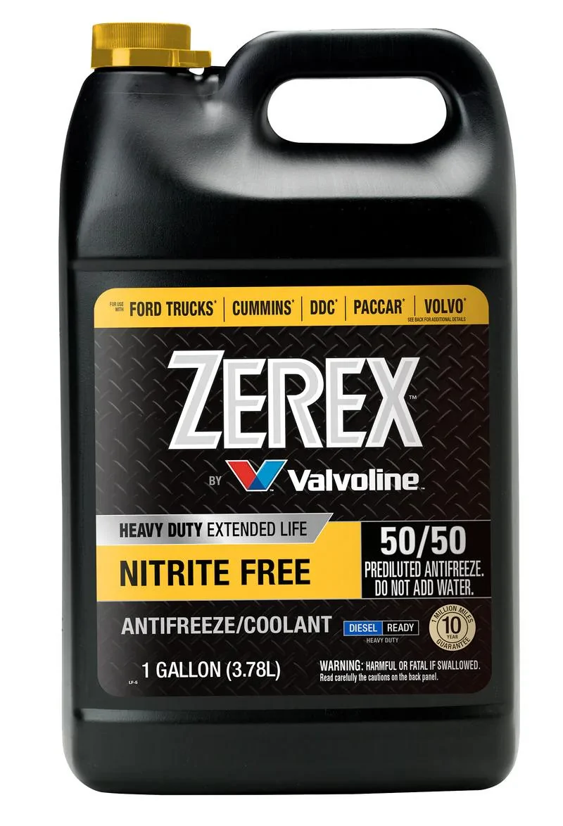

I just topped off with Zerex Heavy Duty Nitrate free yellow pre-deluted coolant but was considering their Hybrid vehicle yellow. Anyone used this or considered it? I don't have a clue how it would be much improved over the regular yellow given this hybrid system seems to be very low temp, low impact.
Ford F-150 Coolant low and changing color Zerex yello
Ford F-150 Coolant low and changing color Zerex yellow2
Also, do you think I'm ok using Zerex vs. Motorcraft? It seems to me most non-manufacturer products are formulated as well or better nowadays, especially now that coolants have split into specific formulations for different products. E.g., pink, red, yellow, etc...

Not sure it would make much difference between those two or SuperTech yellow if you're adding a few ounces.

Bringing the level just up to the top of the Max level arrow point, I think I added just over a quart based on the markings on the jug. I will continue to monitor as always, but I really don't think there's anything wrong or leaking. I think it was just never completely full and time/heat has discolored it a bit.
