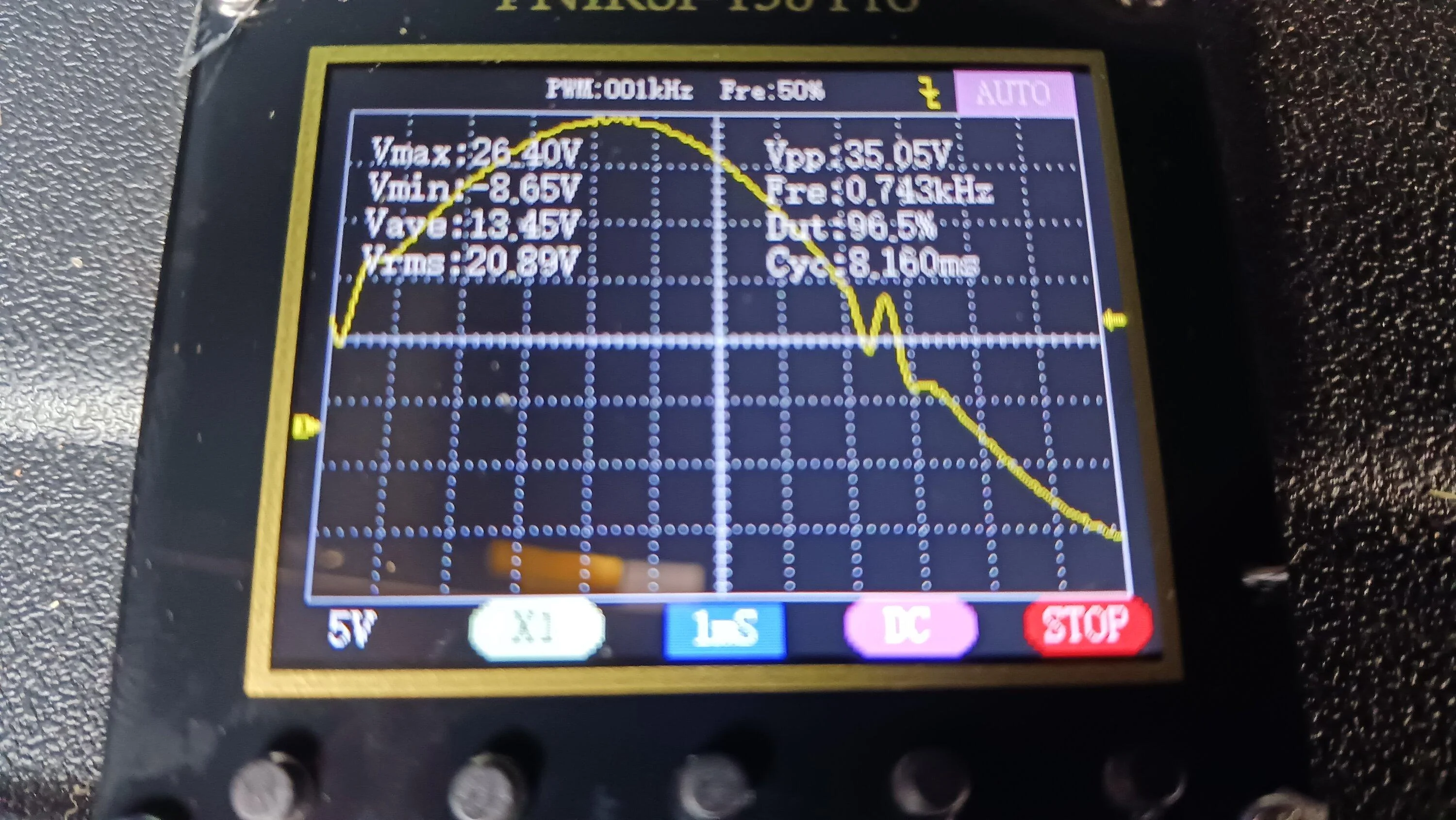

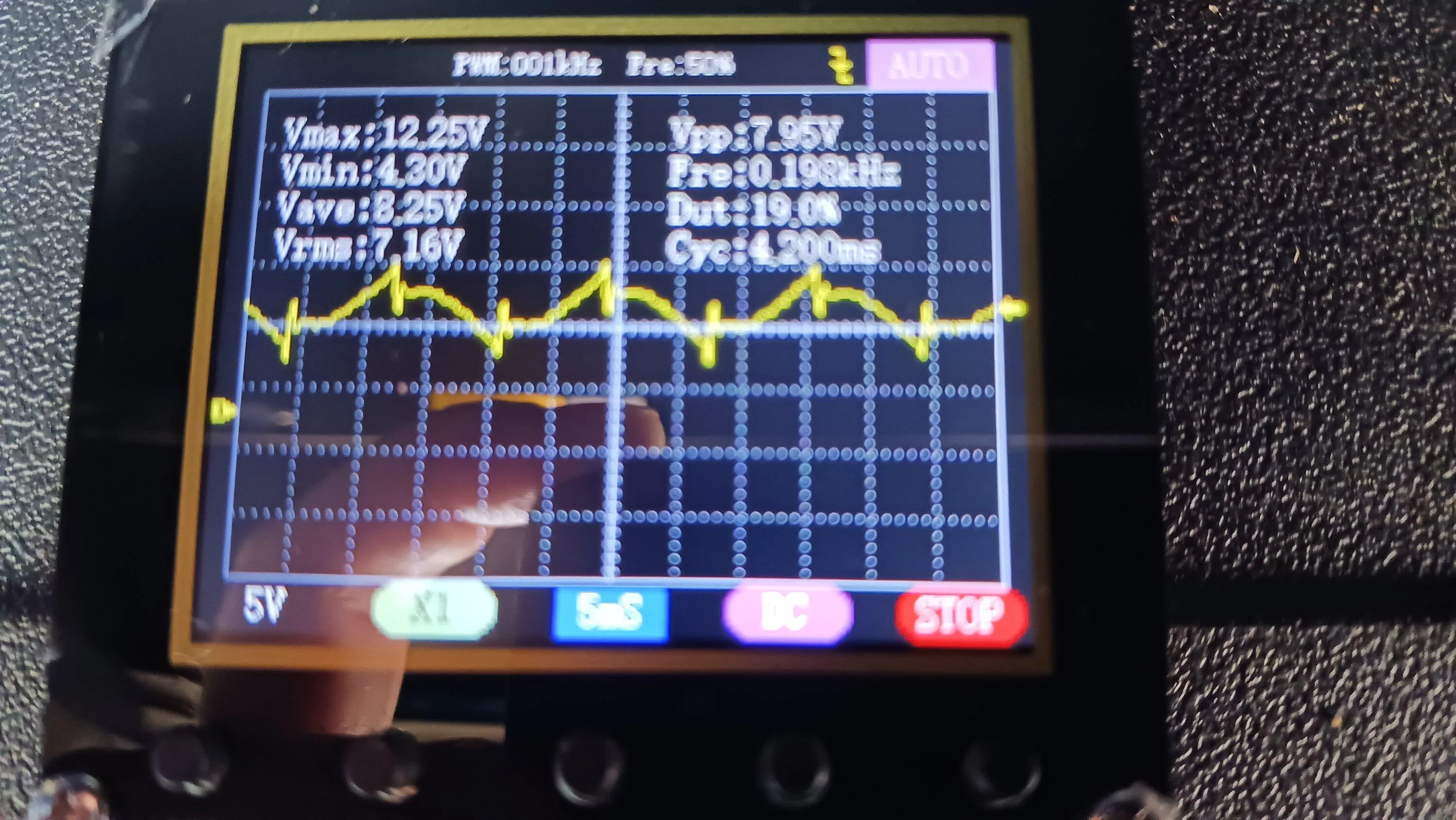

Update.
One, purchased a cheap scope to look at the waveform and it's ugly. So ugly both the multimeter and scope can't decide what the frequency is (anywhere from 160 Hz to 740 Hz). I'm guessing this is a bad run of inverters.
Two, a Ford rep from this site contacted and opened a case. Fingers crossed.
Three, out of curiosity, plugged our RV surge protector into the cheapest inverter we have ($19) and the power light came on. It works with any power source other than the truck's inverter.
Four, I'd recommend anyone with the 2KW inverter to not plug any sensitive (i.e. expensive) electronics into your truck until you verify it's clean.
P.S. Disregard some of the voltage values on the cheap scope... they vary depending on the settings. The waveform is really the important part.

Wow that's nasty.
