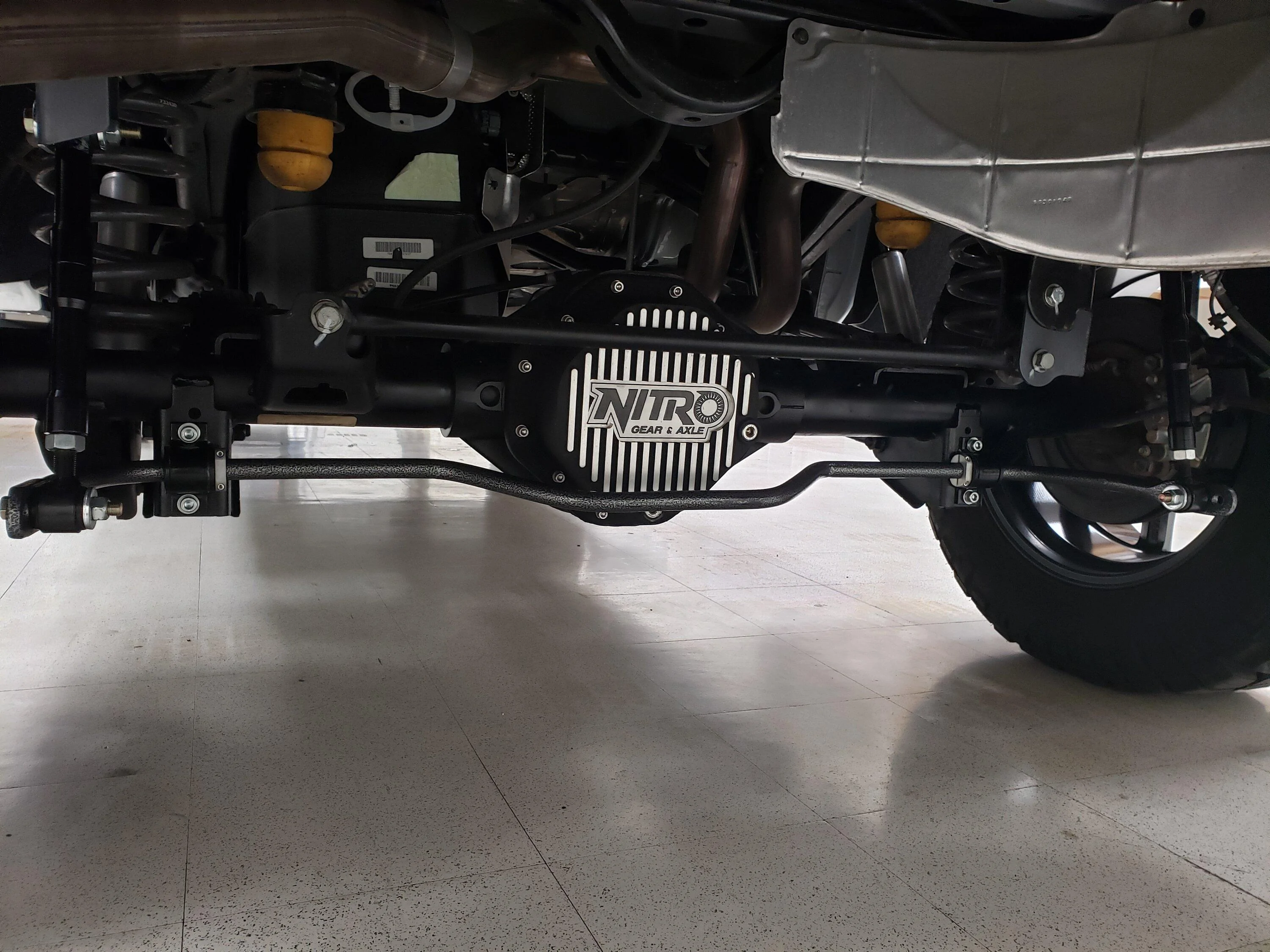

I did on my Ram, used a Nitro Gear. Considered my F150, haven't decided on which brand yet
