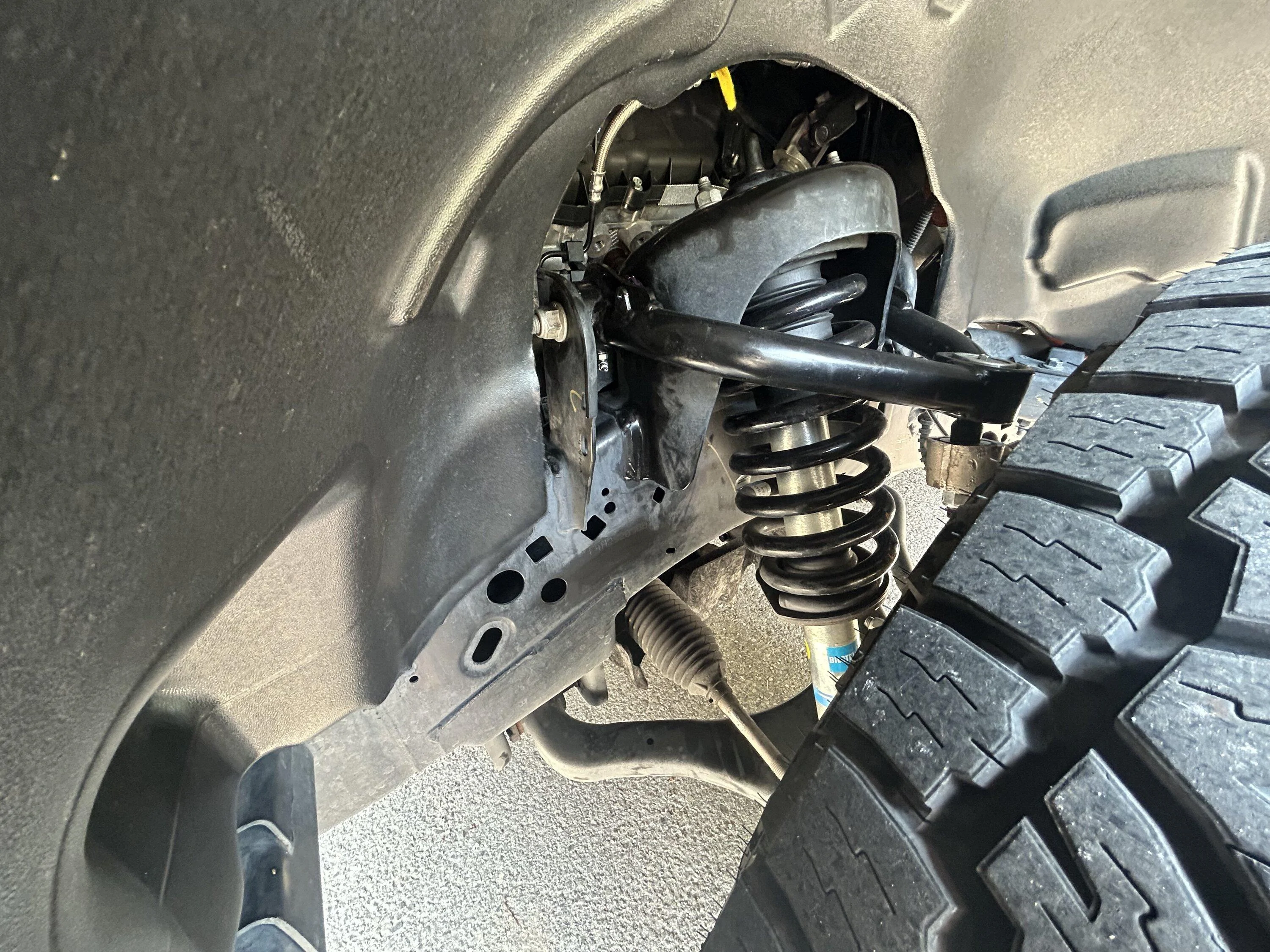

It says 04-22. That’s the first thing that scares me. Second there are no reviews. Third they are ~$460. Forth it says uniball then clearly shows a sealed ball joint. I would say they might be worth while for on road driving if you replace the ‘uniball’ with a moog joint. But besides that just pony up on a BDS or ICON arm that is actually designed for our trucks. Remember your in a ~$40-70,000 thousand dollar truck don’t ruin it with garbage parts!
https://www.stage3motorsports.com/98502dj-21-22-f150-icon-delta-joint-tubular-ucas.html
https://www.stage3motorsports.com/123261-21-22-f150-bds-tubular-ball-joint-ucas-no-sensor.html
I would personally say go ICON delta joint, they perform awesome!

Maxtrac makes some, and Id trust their stuff. Ive used it on lifts, and we've used on 2-3 company trucks. $430

So 04+ will also fit the 21+ ? I know it’s close but I was under impression it’s different geometry

The Uniball icon is very expensive and if you’re not offroading a lot, a regular style ball joint is better. I’ve had to service many of the uniball uca because they creak and moan

There arms are outfitted with the delta joint, it’s a hybrid joint. I’ve had great results with mine.
