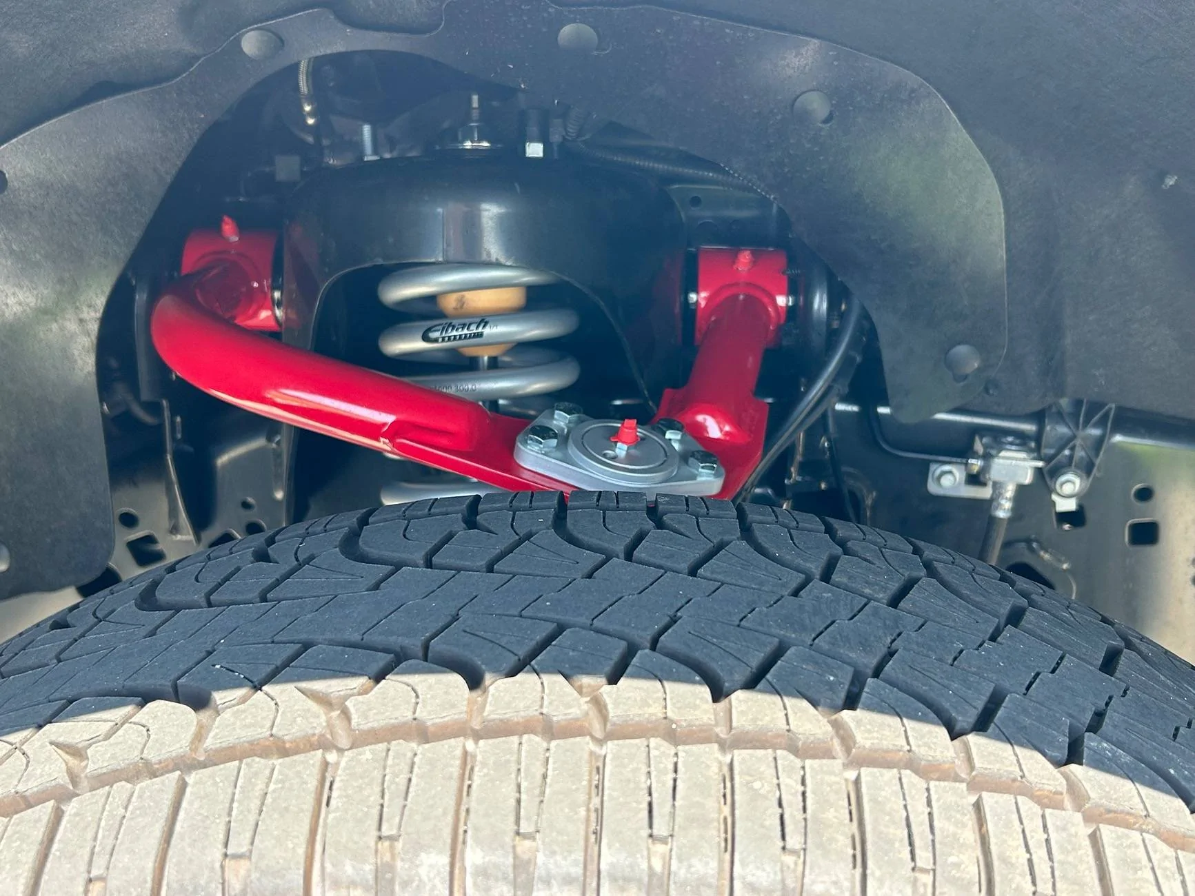

I chose JBAs because the bushings and BJs are greasable and the BJs can be replaced without a puller while still on the truck. They are beefy, so…….
Im running 35x11.50s with 3/8” spacers and the larger inside knobs of my tires just kiss the front side of the JBAs at full lock.
