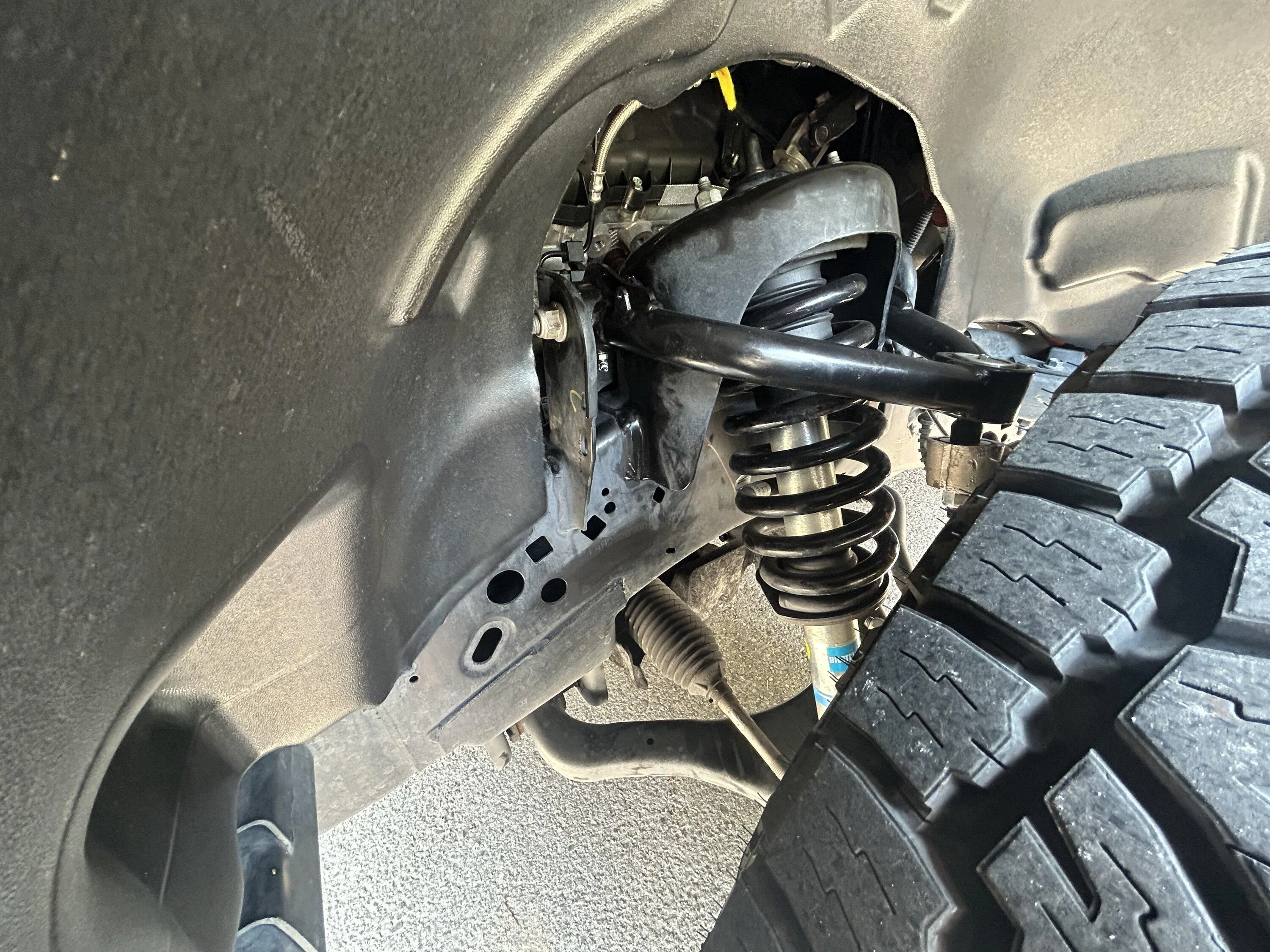

Def can be a DIY install. If you installed the leveling kit on your truck it is almost the exact same steps to install the uca. I would recommend an alignment right after install, when I did mine everything was way out of wack in the front end.
Ford F-150 UCA replacement diy? IMG_2931
