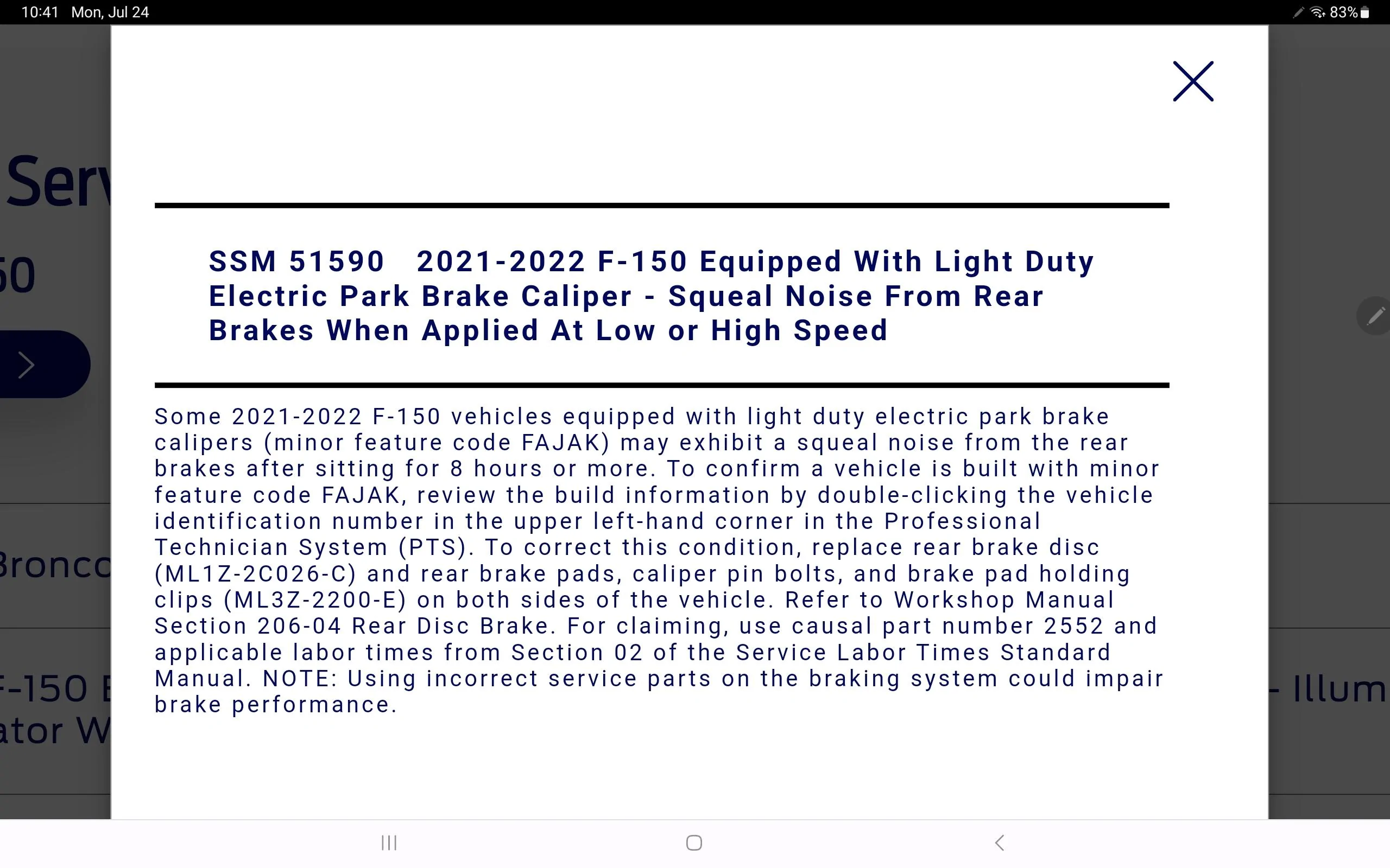

If you would like to know if you're trucks rear brakes are the feature code FAJAK. before approaching your dealer. You can either PM or post in the vin look up thread you're vin to @rugedraw include the screen shot and he should be able to confirm the build code in PTS for you. You'll then have an ace in the hole when you talk to your dealer. Good luck!
Edit; it's not a TSB it's a service action, which basically tells the dealer to do it under warranty and it will be covered.
Maybe I should have read this thread before responding to the PM's about this. lol

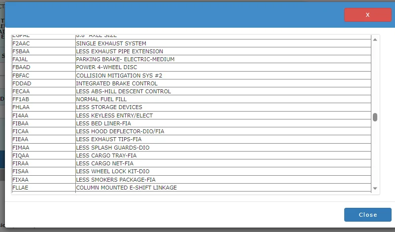

Where do I look up the "FAJAK" build code in PTS? I don't see it under the "Vehicle ID" tab which is where I assume it would be.
If I remember correctly, in the vehicle home screen information somewhere about halfway down the screen in the center there will be build information. When you click on it, and will bring up a list of codes for all of the options and information about how the truck was built at the factory.
Ruge under Oasis results, vehicle information, click additional information.
Ford F-150 Brake Squeak 1690292156603
