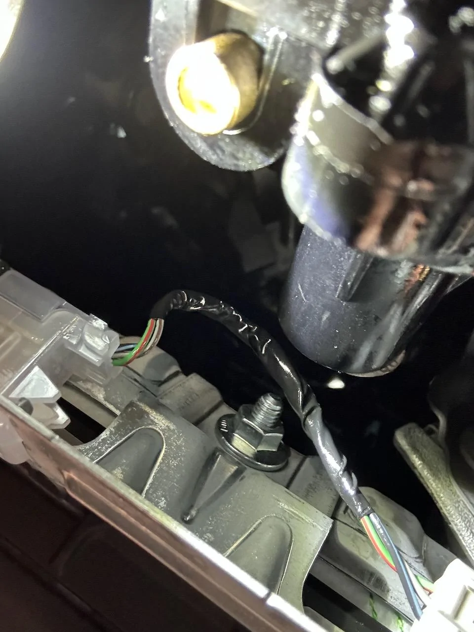

However, that single click you describe when braking post repair; do you have ambient lighting in your truck? I had the same thing. It was so much more tolerable than the failed EBB I told myself I could deal with it. A few days later I was still hearing it over phone calls and podcasts so I decided I was going to take it back in. I crawled onto the floor and looked up at the brake assembly. As I moved the pedal I noticed a single string of wires leading to the ambient lighting bulb was touching the assembly itself. Once I moved them the click disappeared. I ended up using a zip tie and lightly cinching it down to keep those wires out of the way and my brakes are now totally normal. I'm attaching photos of the wires I'm talking about.

Thanks Larry for the hint! i dont have the ambient lighting but i took a look under there and didn't see anything obstructing the movement. I will mention it on my next service but it is a livable issue for the moment.
