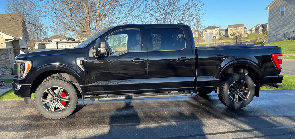

The ride quality shouldn't change no matter where you set the spring height, it will only change the appearance of the truck. Bilstein is a reputable/quality manufacturer and I'm sure they have the strut engineered to perform equally at minimum and maximum settings.
If you are thinking you want to go to 2.5" setting just to make the truck 100% level while sitting still, I think you'll find out that it will look as though the rear is squatting a bit. I would shoot for a minimum of 1" of rake front to rear for appearance sake.
I'm using the 1.5" setting, but I also have removed the rear spacer block, and added airbags in the rear, and the photo is on a slanted driveway, so my situation is not a good representation of anything, just throwing the photo in here to keep things interesting. However if you only focus on the front, that is tire to fender spacing of the 1.5" setting.

It won't perform "equally" at different pre-load settings, but it should perform appropriately.
Pre-load settings? The settings on the Bilstien 5100 is just the location of the strut body to the bottom of the spring, this doesn't change the compression of the spring and there are no adjustments on the strut valving, so that doesn't change, it will only change the position the strut is running internally. So either I'm confused or you're confused, if it is me I welcome the education...
