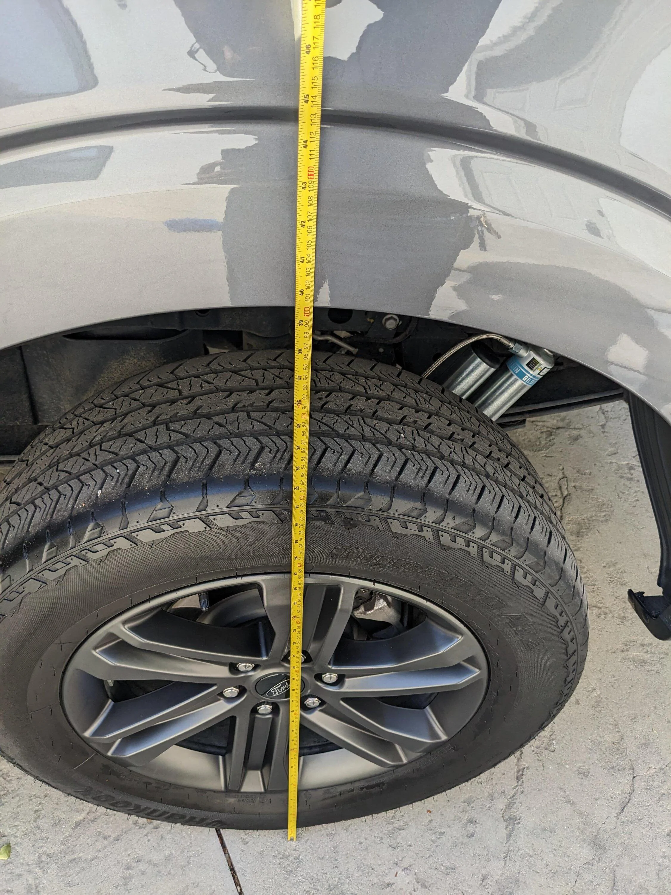

After about 700 miles both front and rear have settled about .5" on my powerboost. I was hoping for some rake, but I shouldn't complain I guess, the result was a perfect level with no payload. Hopefully this helps all of you with the same problem of upgrading shocks on a powerboost with baseline numbers/stock wheels and tires.
Before (Front 37.25", Rear 39.75"):
Ford F-150 Bilstein 5100 Settings and Resulting Lift PXL_20230215_163859902 (1)
Right after install:
Ford F-150 Bilstein 5100 Settings and Resulting Lift PXL_20230216_013813801 (1)
Ford F-150 Bilstein 5100 Settings and Resulting Lift PXL_20230217_193117265
Ford F-150 Bilstein 5100 Settings and Resulting Lift PXL_20230217_193140889
After 700 miles:
Ford F-150 Bilstein 5100 Settings and Resulting Lift PXL_20230308_185003819
Ford F-150 Bilstein 5100 Settings and Resulting Lift PXL_20230308_184945092
Ford F-150 Bilstein 5100 Settings and Resulting Lift PXL_20230308_185120692
Ford F-150 Bilstein 5100 Settings and Resulting Lift PXL_20230308_185139547
