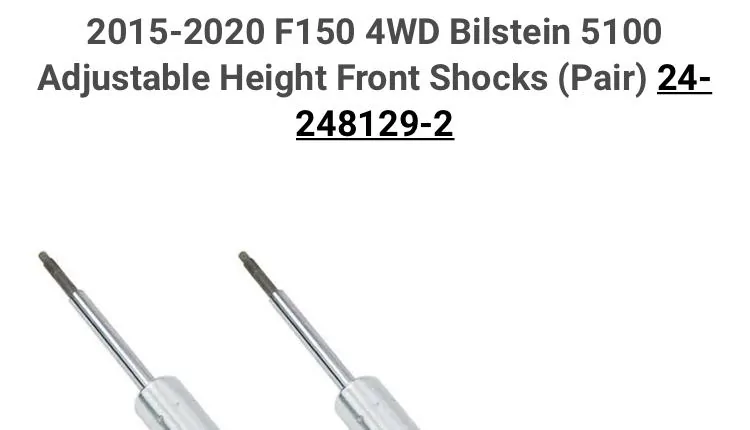

The only thing I have noticed is less down travel. When going over certain dips you can feel the front end drop. Maybe longer upper control arms would fix it? I’m not sure yet, but will test it out.
I have the same complaint with my fox 2.0 and the down travel. It’s not the UCA’s and u can see this if you jack your front end up, they are nowhere close to touching. It’s the actual extended length of the shock that is the limit. UCA’s seem to be the limit when you use a puck
