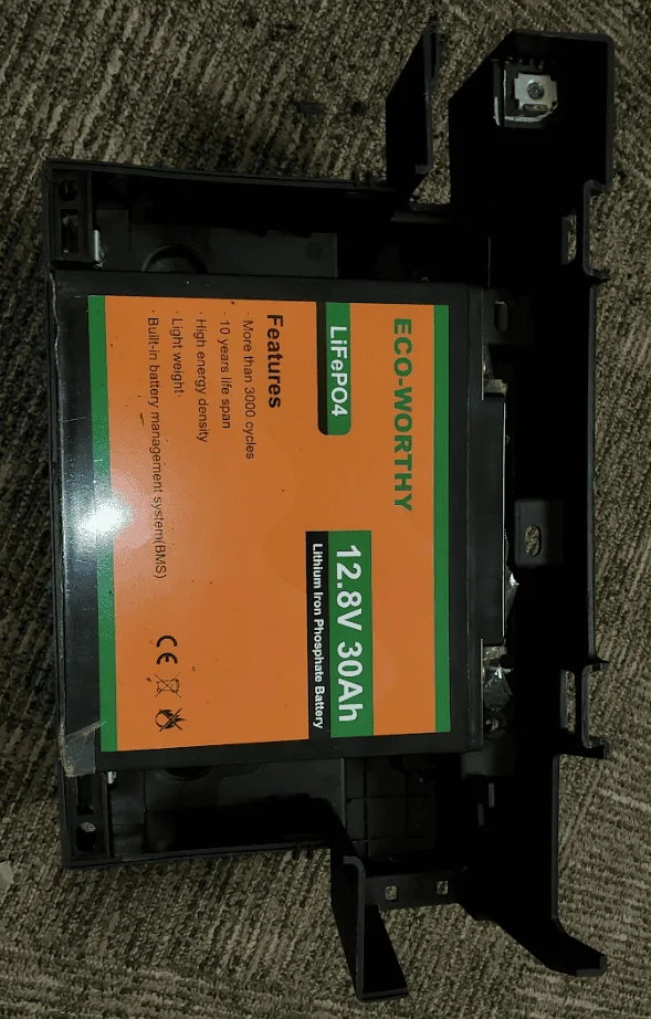

This is the 30ah in particular that can have the battery box cut up to make it fit. 30ah "mini" https://www.amazon.com/dp/B0C3CZQCKP
I didn't put in the modified box shown below (bought extra batt box off ebay), it's just connected up with 8ga wires currently. The box needs certain parts cut up to fit / close up like it should. The box is actually 3 different parts including the lid. Same box for either the PB or the 2kW ICE trucks.

That's pretty amazing that you aren't dropping a quick ~.5V with approach features dragging on the 12V battery(s)
So the little LFP is what's holding the LV head up before the DC/DC converter is available to help out?

The LV is currently sitting at 3.17v right now, I've woken it up a few more times just to see what'd happen. For these tests the 7ah is still sitting installed as it should be, I simply tapped the LFP into its - screw and utilized the threaded post on the positive to attach it (there's a little threaded post under the red cover that I have a nut for). I haven't turned the key on, but if I turned on accessory, the DC/DC would supply 12.75v or so. Most of the LFP's power is in the 3.2v-3.4v range (temp dependent) so when it drops down to 12.6 or so at these temps, that's when the AGM starts to back it up if higher amperage is pulled. It's a much different story with my larger ones, I've got a 110ah unit I'm still working on that will let the truck pull 50 amps from while staying above 13v (this is the long-term battery for the truck though it's physically 10% larger than I need it to be to fit nicely), and the 280ah isn't phased by anything.
It turns out due to the v droop of the smaller batt, it's really the best size because it charges almost capacitor like, but will droop enough under load that it's not handling higher amperages. It'll eat as much amperage as possible up until around 14.2v as it's almost full then. The benefit is that it retains that higher resting voltage which happens to be a perfect float voltage for the AGM so it will slowly trickle it to 100% SOC and the small loads of accessing the truck it handles entirely. Once it goes back to 'sleep', if any power was pulled from the AGM, it floats it right back up to full. What this translates to is ~25ah worth of reserve power before the under-hood AGM begins to drop below 100% SOC.
