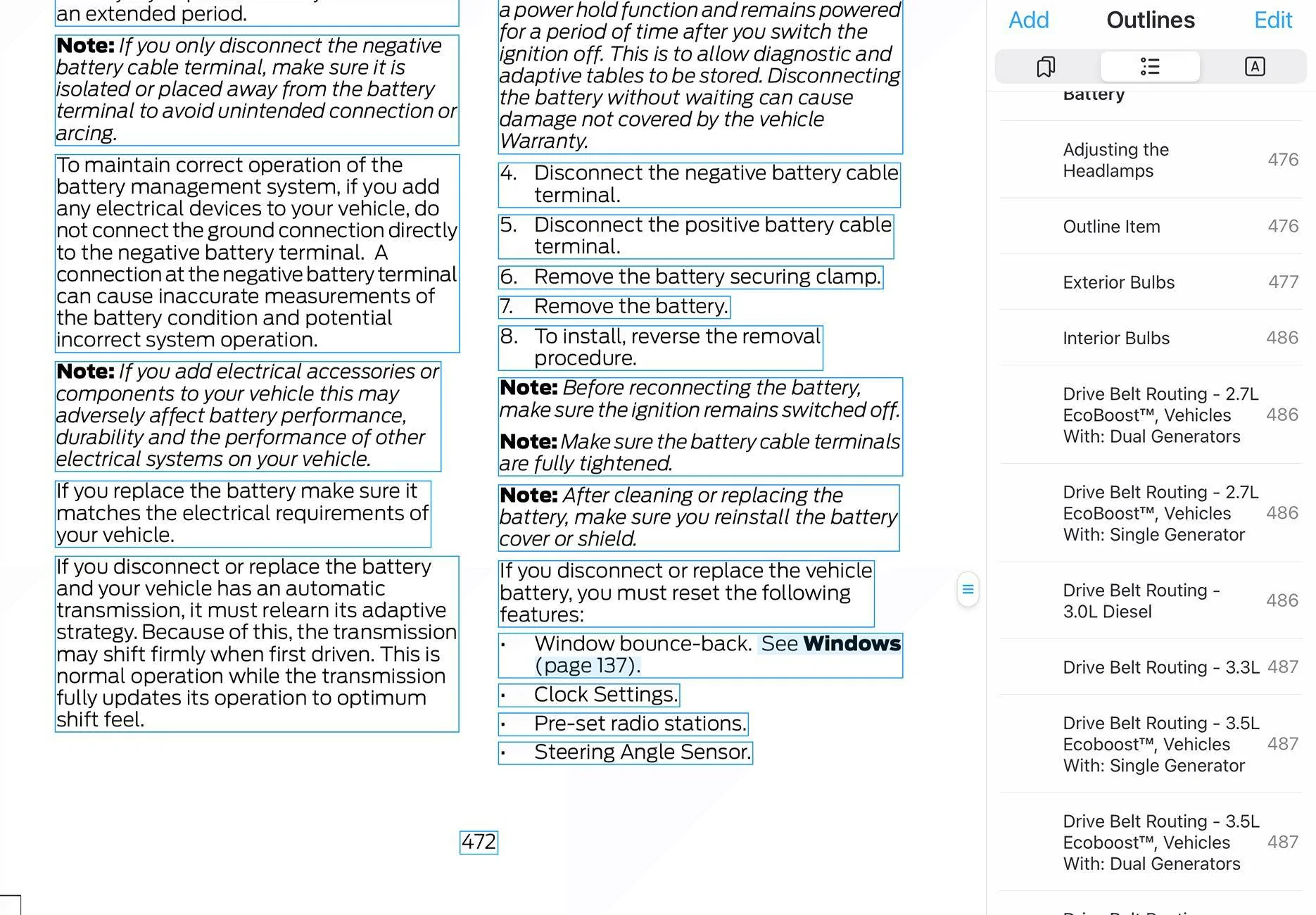

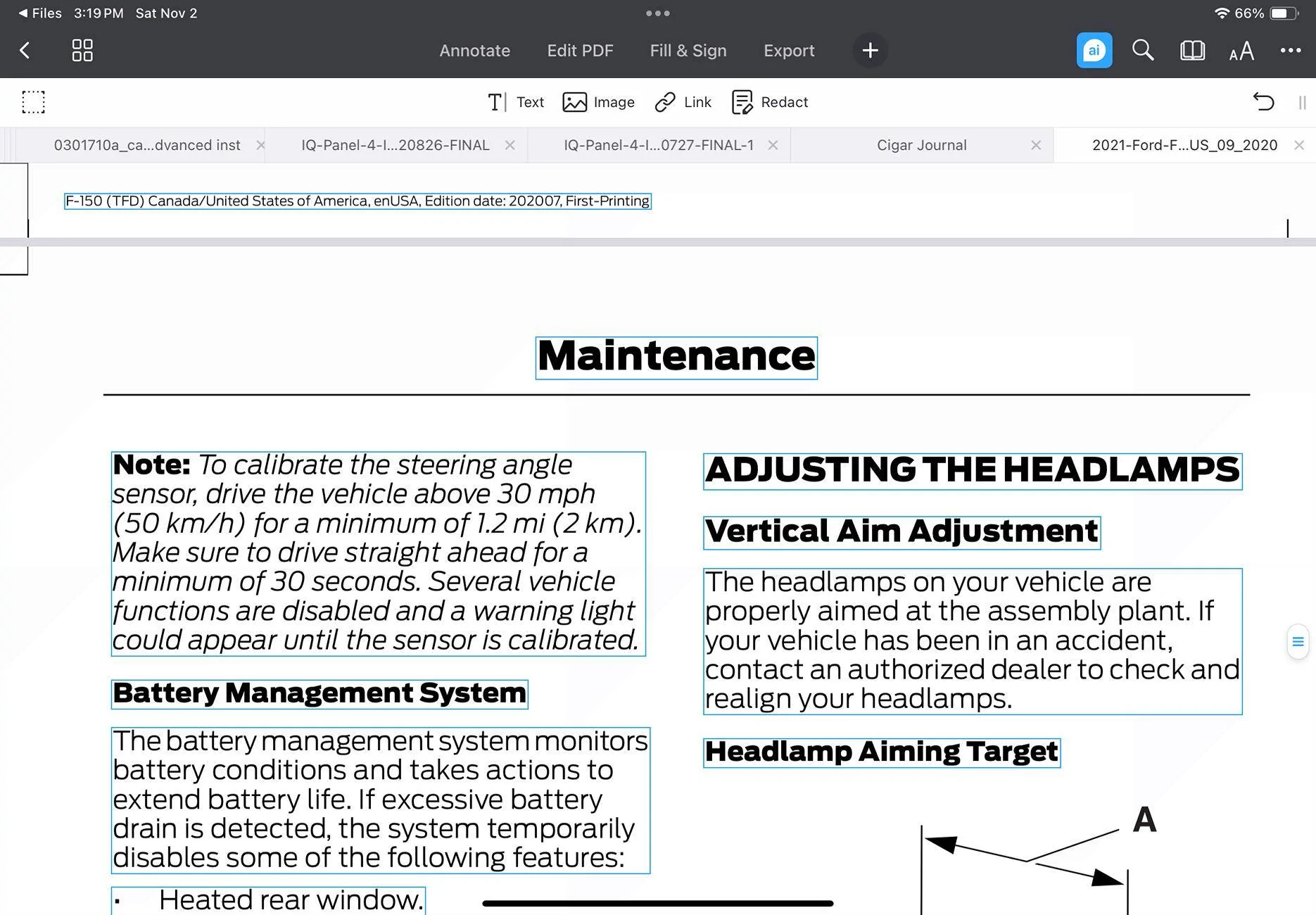

I just changed my battery in my 2021, 5.0 engine. I installed the H8 battery (the one for the diesel). In the owners manual it says I need to calibrate the steering angle sensor. Did any of you do this step? Seethe attached screenshot from the manual.
No, you don't need to do this. Just reset the BMS and you're ready to go. I Changed my 21 5.0 to an H8 a couple of years ago, haven't had a problem since then.

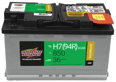

I just replaced mine a few days ago w/ the Interstate H7 AGM battery from Costco:

Odd thing was that the day prior to changing it, Ford dealership did the oil change and checked the battery as "good" but yet I was still having issues w/ the welcome lighting coming on and the battery saver message popping up.
Not having any further issues after the battery change

All the tech probably did was put a load tester on the battery and it passed. Did not do the test that takes a hr or 2 that Ford needs to fail the battery.
