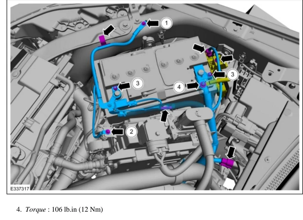

Be sure to hook up the negative lead of the trickle charger properly, in order for the BMS to see/be aware of the current that you are feeding into the battery.
In other words, don't use the actual negative post on the battery.
#1 or #2 in the image below would be great spots
I went a little overkill with my tender at ten amps. Having said that I tied my negative in at position #1 as it was the easiest and cleanest to route everything to.
Any idea what #3 is?
At the moment, I have the ring terminals for a Battery Tender
