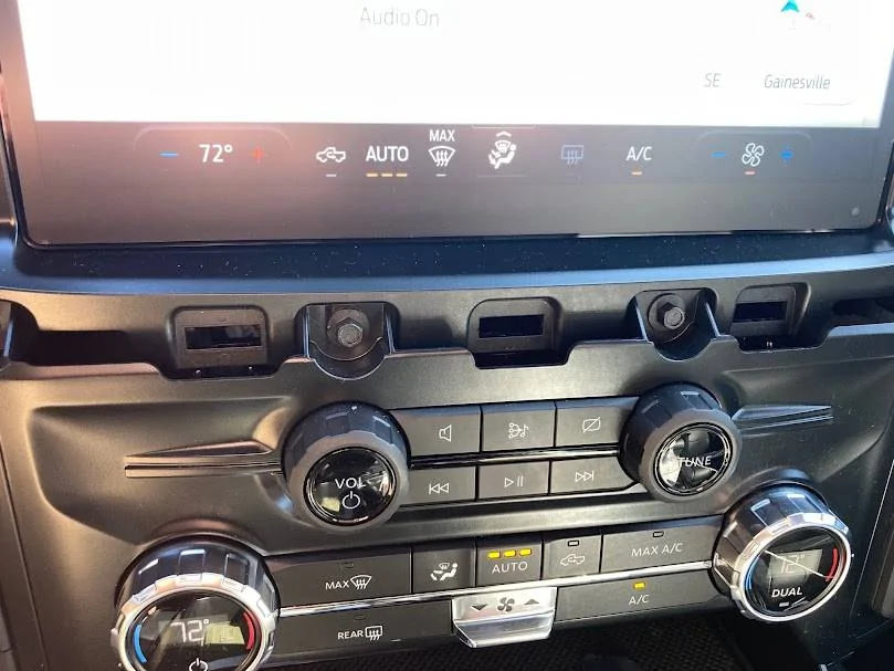

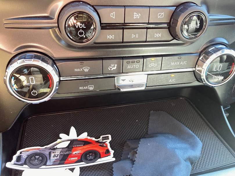

I’ve purchased this module for my stx everything seams to work except the ac compressor will not come on and the button Dosent do anything if someone. An point me to a thread or the forscan changes to install this I would appreciate I cannot seam to find it anywhere thanks in advance
Did you ever figure it out!??
el_montero
Enrique
Feb 13, 2025
California
2024 F150 RCSB
Yes, see the 518 Motors info in the threads above...write that data and good to go!
I did it last night! I was confused on all the coding then caught on what to input lmao! Thanks guys
