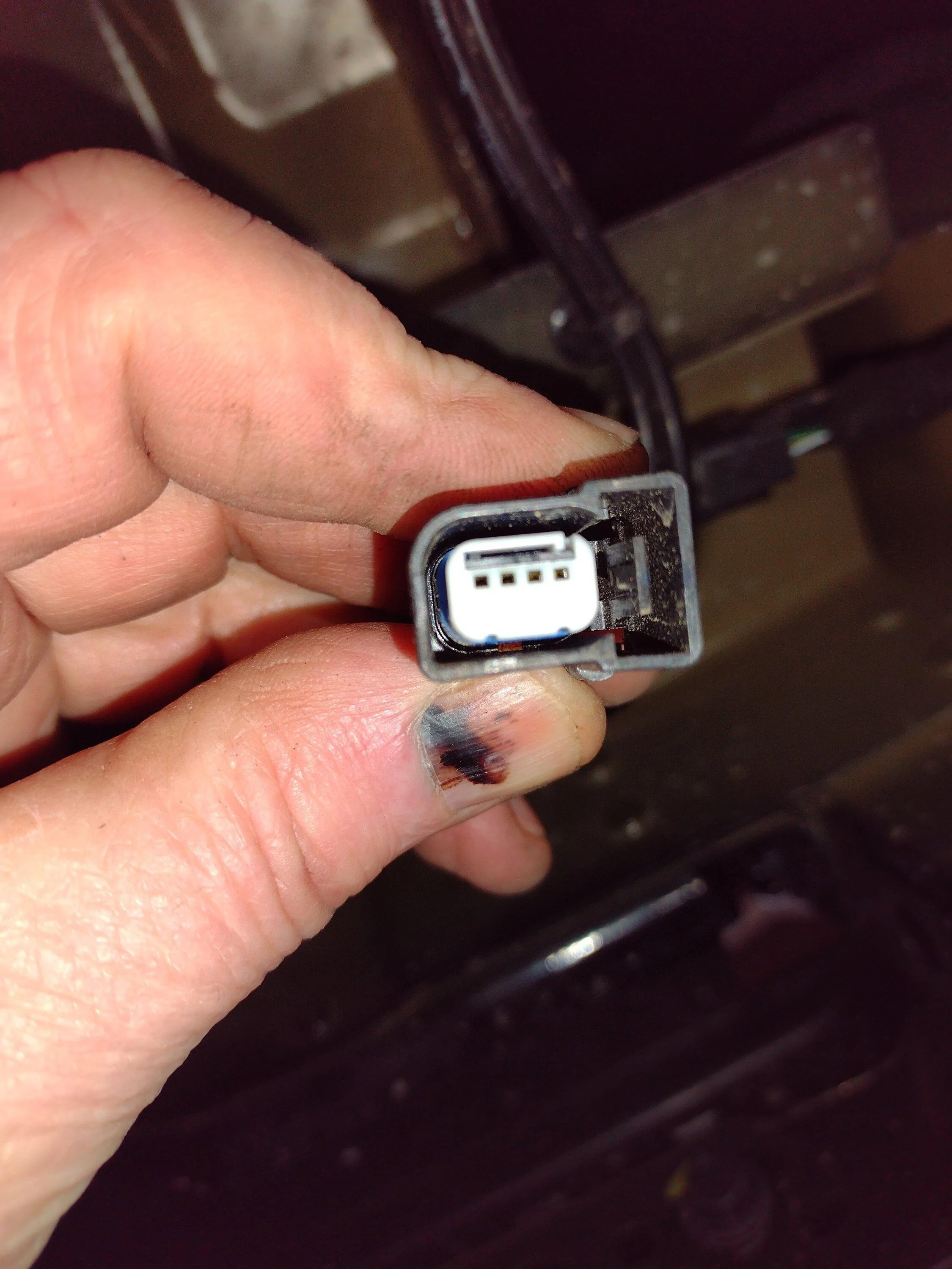

What issue did you have? What were the symptoms?
Just like you intermittent use problems with errors. The 2 small wires are low voltage wires that are for sensing and if the connection is not in optimal condition these sensing system are basically going to give headaches.
It is a must that these connection are in good operating condition as these wires are constantly monitored and the slightest flick of a bad circuit the equipment is shut down
These low voltage sensing circuits are at very low voltage and current and do not have the power to jump or pass through any corrosion or contamination of the connector thus giving a faulty signal to the cpu which then shuts down the power circuit. You hit the right bump and it may or may not be enough to make a complete circuit then getting into the bed or putting something in the bed maybe enough to momentary open the circuit.
Good luck.
Good luck.
I haven't had any problems, but your advice is certainly sound. Thank you.
