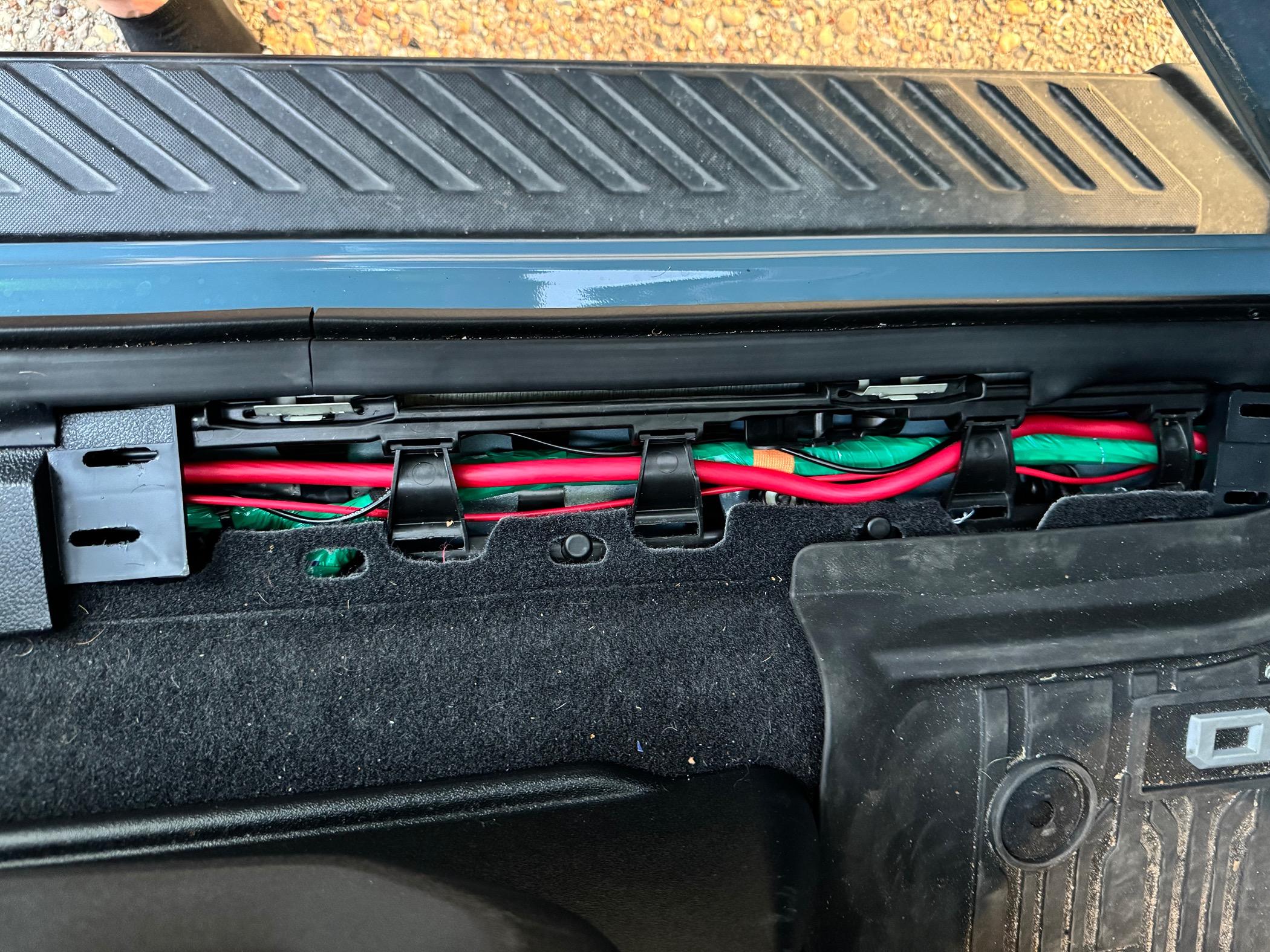

Kicker cx800.1
I did not want to mess with grommets that had factory wiring so I ran power down driver side under trim pieces. Down under the truck via blank grommet in floorboard. Wrapped in heavy duty plastic shielding and wrapped in double layered electric tape with another bundle of wires that runs along the frame under the truck and up into engine bay

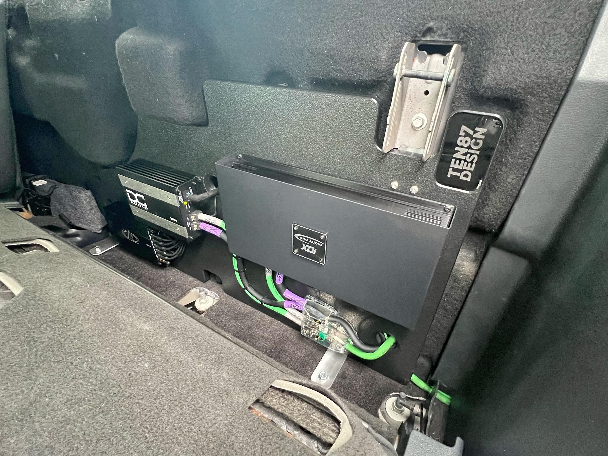

I second these guys. I have their amp rack, door kits, and custom in house wire harness to hook everything up in my non-b&o system. Guys are super knowledgeable and will answer any questions you may have. 100% recommend them.

I installed a DD Audio DSI-3 DSP from the head unit to the amps using your custom harness. I assumed it flattened the signal and I have tuned and time aligned the speakers to the driver with the software (graphic equalizer, crossovers, summed signal, etc). I want to know if I was mistaken that the signal wasn’t flattened or there’s a need to install something like you mentioned? Or the other option is forscan to flatten the signal. Just curious because my system sounds great, just didn’t know if I’m missing out on the full potential.
The DSP can only do so much. Go in ForSCAN and turn off the EQ, then re-tune and set gains. The difference should be substantial.
