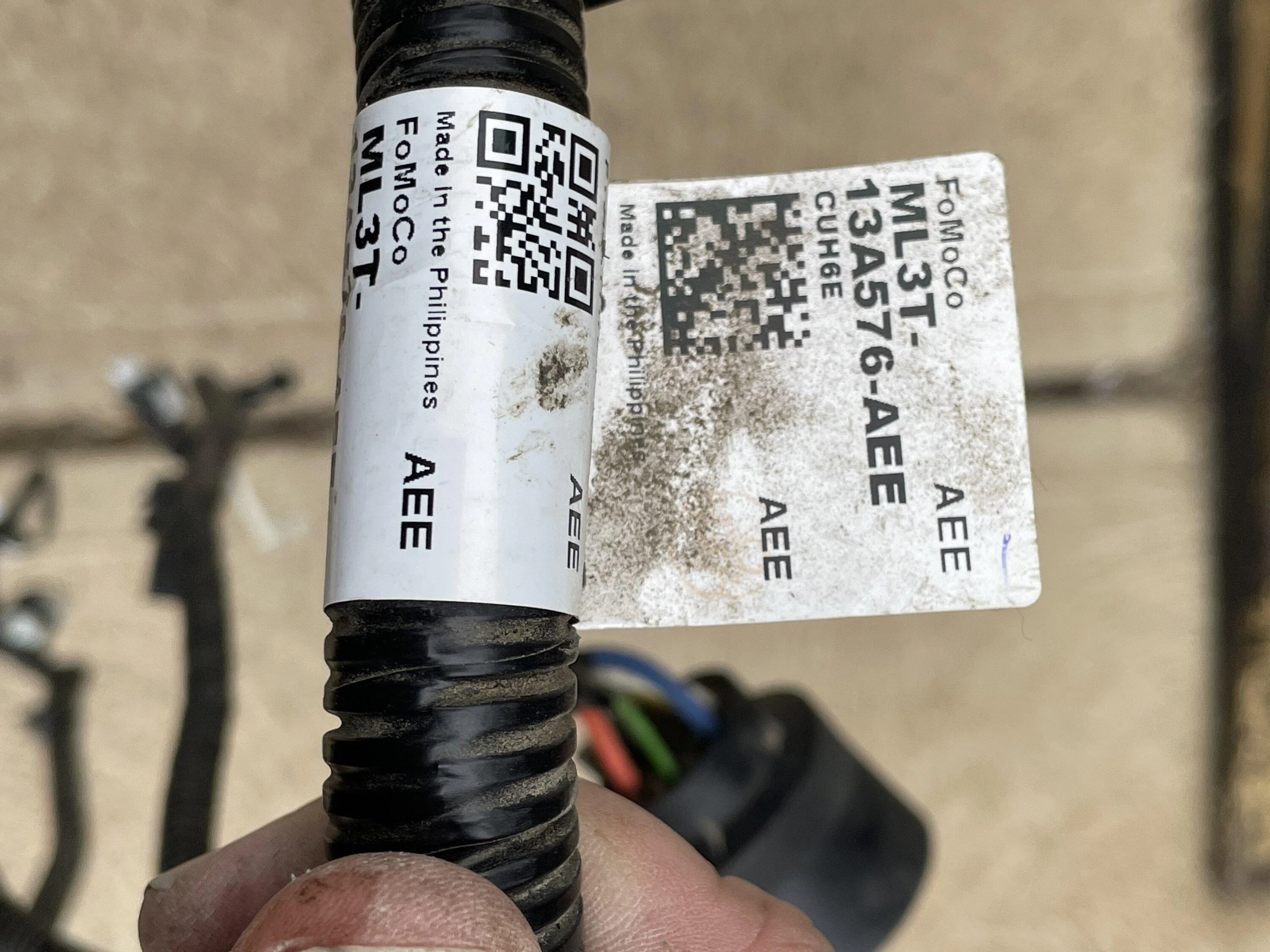

I ordered the "TFA" harness. Box from Tasca Parts came today. Looks like the part recieved is now a "TFC". ML3T-13A576-TFC I'm guessing it is an updated part number. It looks like the harness I expected. I haven't had a chance to put it on yet (it just arrived an hour ago), but did lay up under the truck with it and it appears to be right. With the obviouse expected exception of the dual exhaust brackets and 2 extra sensor pulgs (for 6 bumper sensors not 4).
My new question is:
On the outside bumper sensor connectors, which ones do you use and which ones do you leave disconnected and tied up? They do have different wire colors. The old harness is taped up all the way to overlap the connectors, so I can't see the colors on it while it's still up in place. I hoped it would be obvious by the way the harnes lays in place, but deosn't seem so obvious yet.

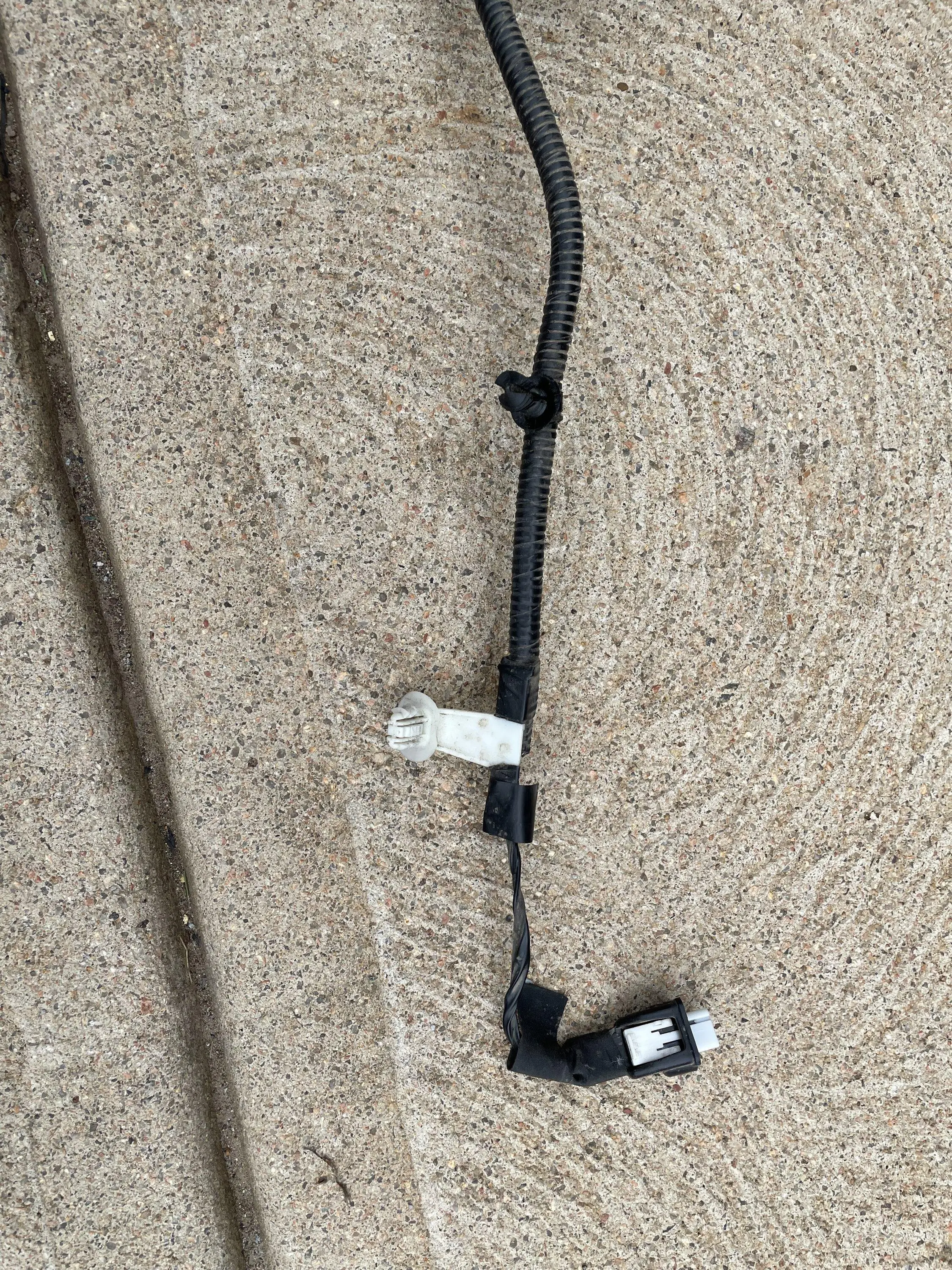

Here's the harness pulled off for comparisson. "AEE" harness. It really is an easy install for anyone considering it.
Everything lines up and clipped in just fine. One side of the dual exhaust brackets fit into one of the holes. Wire tied the other end to the bumper brace. For some reason, the big main harness plug was a bitch to get appart. That took as long to get appart as putting the whole harness in. After flipping the release arm all of the way open, it wouldn't come out. It took a little gentle ptying with a small flat blade screwdriver to get it to com the rest of the way apart (trying not to break anything)???
The white bracket in the poto is the only difference in the harnesses. All of the other clips and pins are all there and in the right places. You could easily transplant it to the new harness if you wanted, but it all fit fine with the "wrong" dual exhaust brackets.
Sensors are all working fine. Now i need to get a camera / TPMS set to put on the camper.

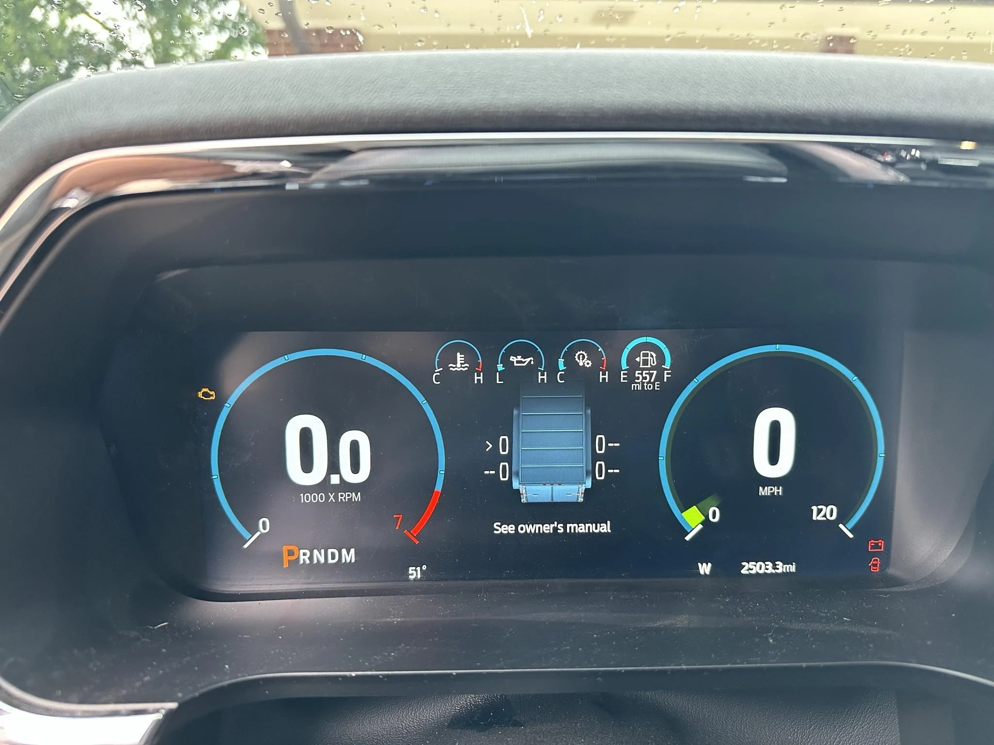

TPMS setup works in the dash screen under trailer info. It asked how many tires (2,4 or 6) and what pressure. Then it went into the sensor setup, but I don't have them installed yet.
Ford F-150 Any update on a Trailer TPMS system? TPMS1
Ford F-150 Any update on a Trailer TPMS system? TPMS2
Pro trailer recognized the yaw sensor (not inclcuded in the kit) and wanted to do the driving setup. No looking for the sticker like before.
The trailer camera shows up both in the normal 360 camera selection as the Aux camera, and also shows up when pro trailer is turned on.
