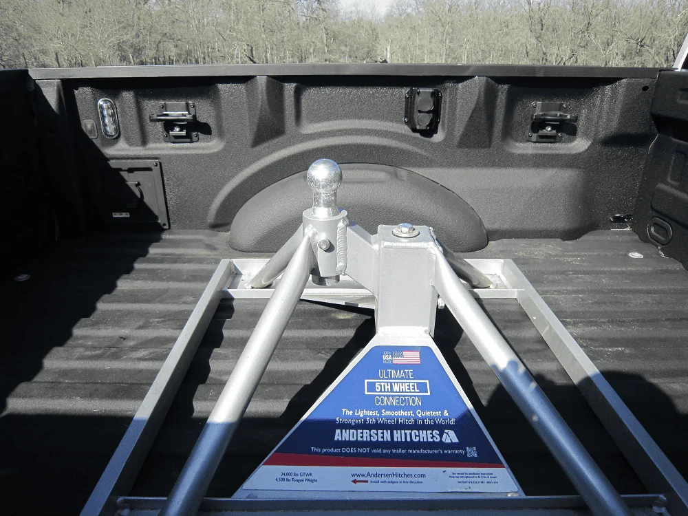

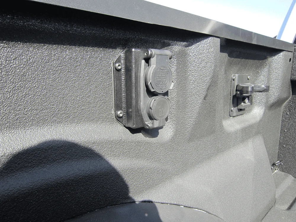

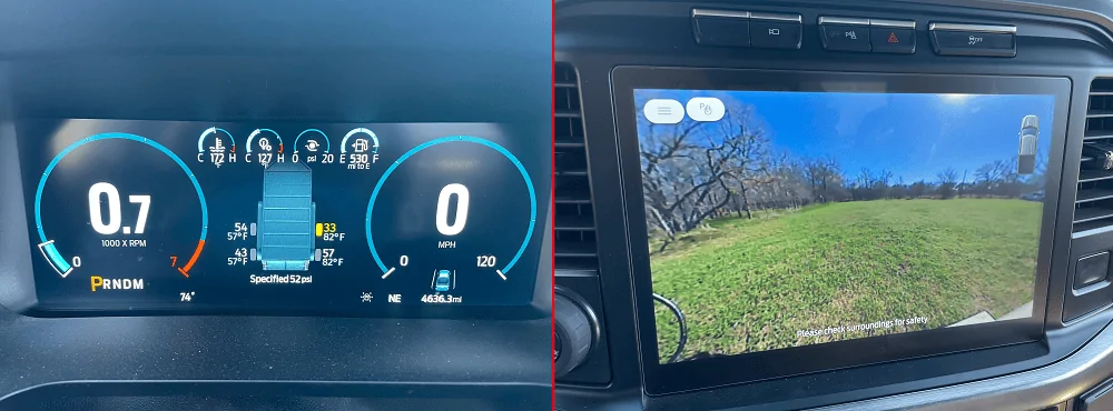

The pics
Ford F-150 Any update on a Trailer TPMS system? TRUCK 05 - EXTENSION BACK OF BUMPER
Ford F-150 Any update on a Trailer TPMS system? TRUCK 06 - BEDISDE 7-12 PIN SOCKET 01
Ford F-150 Any update on a Trailer TPMS system? TRUCK 06 - BEDISDE 7-12 PIN SOCKET 02
Ford F-150 Any update on a Trailer TPMS system? TRUCK 07 - SCREENSHOTS TRAILER TPMS-CAM
I'm very happy with how this turned out, it really is nice for my 5th-wheel rig. :)
