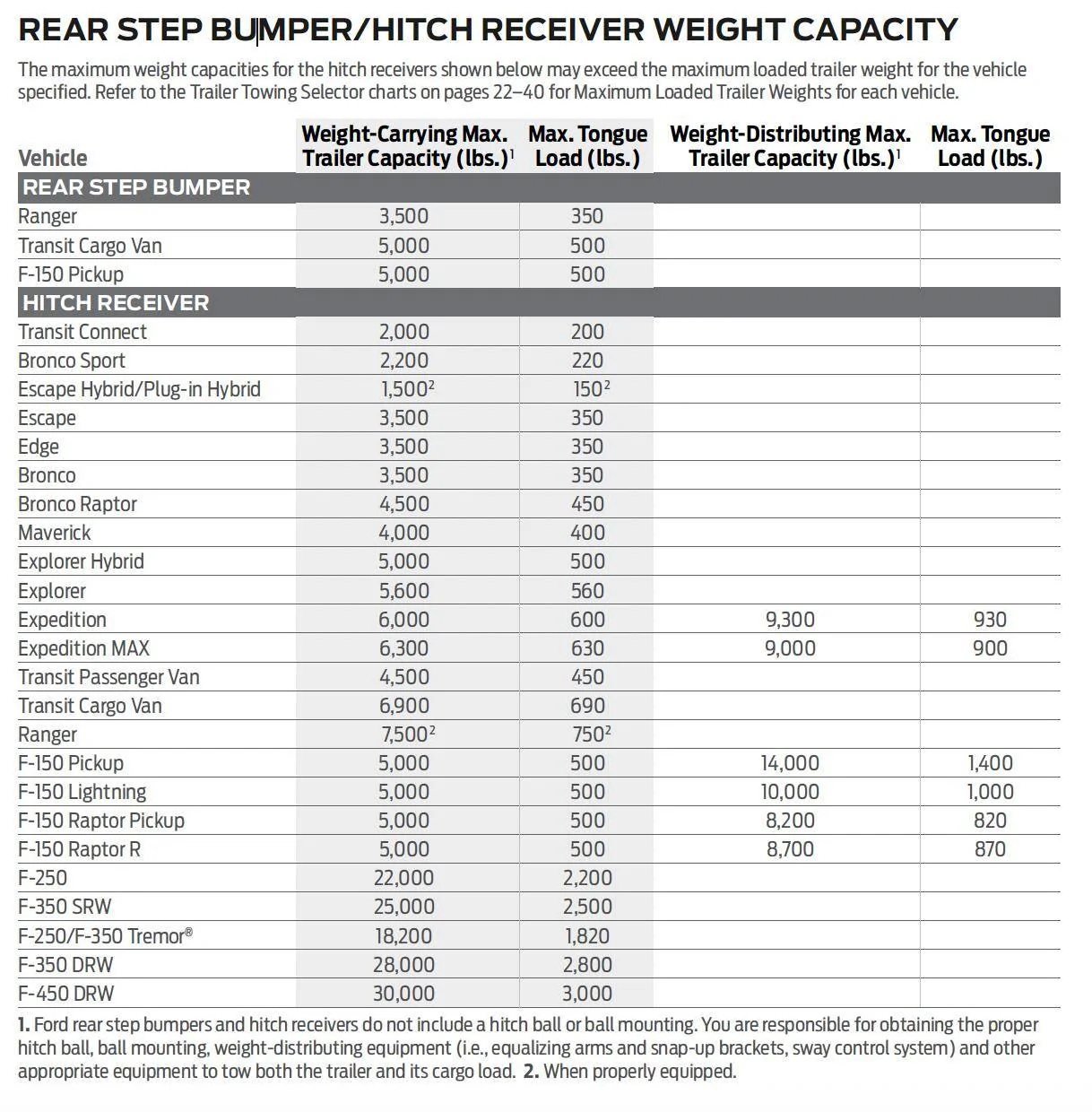

Alright, here's the piece of information I was missing! It was on page 44 of the 2023 towing guide.
(edit) it is also on the hitch sticker, I guess I need new glasses
Weight carrying up to 5,000 lb, weight distributing hitch 5,000-14,000.

This has the Max Tow package. Includes a "Class IV" (ish) hitch, "3/4 float" rear axle etc.
Hitch is rated for 1400/14000 per sticker, vehicle GCWR is 13,800 (only EB MaxTows get this high in F150s).
But the catch, as I posted above, is that it needs to be weight distributing if above 5,000lb trailer load.

Yep, WDH needed or else your tow rating drops to 5,000 lb. So much for Max Tow if you don't have a WDH.

According to the hitch sticker and the Ford towing guide, anything above 500lb on the tongue requires a WDH. (see above)
Yup, I have read the guide, totally understand that Ford says the weight carrying limit of the hitch on the F150 is 500/5000. But lets step through this logically.
