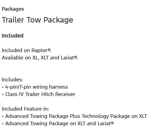

It still boggles my mind that the new Ford Ranger can tow up to 7500 lbs (with appropriate tow package(s) see below), but many of the F-150s are maxed out at 7000 lbs even with a WDH--mine included since I did not get the Max Tow Package. Yes, I understand the whole "tow package" thing, but on the Ranger it is no more than a Class IV hitch, 4/7-pin trailer wiring harness and backup assist. There is no mention of larger radiator/brakes, suspension, alternator, etc... Based on this knowledge, it would appear the F-150 can tow AT LEAST 7500 lbs if you have a Class IV receiver, and a trailer brake controller with 7-pin wiring harness--and a WDH of course. While I am not professing to tow beyond your truck's towing capacity, there does seem to be some ford exemplars that would indicate otherwise. Just my .02.

Trailer brakes are required on 3000 lb trailers and above. 1500 in CA I think. So that's why the max trailer package includes the brake controller. Ford thinks that most people may not tow 3000lb+ trailers with the standard package. And if they do then they can pay to add the controller.
But you aren't getting the max package to tow 3000lb trailers so I am guessing at 7000 and below the standard equipment can take it.

Also, I believe that video was not entirely correct. My truck has the same hitch with the angled chain brackets, and it does not have a max tow package. It came with a 4-pin trailer harness from the factory. I replaced it with the 7-pin harness and installed a trailer brake controller. While they are all Ford factory OEM parts, apparently my towing capacity is still limited to how it came from the factory.

Yes and no. 4 pin doesn’t run trailer brakes. 7 pin will. Adding 7 pin and a trailer brake will make a difference. Still need to stay with in total GVW and pay load.

This statement is confusing me a great deal. The only updates I see are for the smart trailer tow thing and the 7way/4way connecter (which I think are part of the same thing) and the trailer brake controller. I feel like if you performed those updates, you should be able to pull more than 7k pounds, but maybe I am missing something? Of course even if you update the missing stuff, technically speaking by the letter of the law, you still are constrained to the original window sticker. It will never update on fords website.
Of course its likely I am missing something lol.
Yes, one would assume. But that does not seem to be the case based on Ford’s recommendations.

So going to take a stab and say that if your truck is only equipped with a 4 pin connector, and not a 7-way and not a tbc, that is most likely the weight limiting factor.
First off, anything 5k or more being pulled by a 1/2 ton truck, should have a tbc imo. Of course if you don’t have a tbc, you might not have a 7-way, and you would need both properly installed to make it work correctly.
Then, if you are over 5k you should have a wdh, imo.
So again my guess is the lack of these things being installed at time of build, is what constrains the weight ratings. You could put all that stuff on there, but the truck will never be classified to a different weight rating and be legal. So I’d do so at your own risk.

As long as you add the TBC and 7 pin, use a WDH and are within the weight ratings of the truck you will be fine. Only thing stopping you is the TBC and 7 pin. With a 4 pin and no TBC you only set up for basic small trailer. 4 pin only gives you trailer lights.
