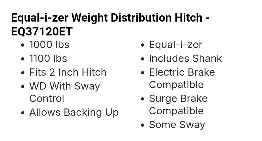

If the trailer has surge brakes do not attempt to use with a WDH.
I pull a boat from Michigan to Florida with surge brakes. I purchased a weight distribution hitch designed to be used with surge brakes. I've heard this false claim a few times. Mine has a lower weight capacity, but this is the type that I use with surge brakes.
How much boat are you pulling that you need weight Distribution?

@adyaro77 , I stand corrected, thank you.
Hey no problem. Hope I didn't come off the rude. Now I know some boat trailers don't want you using them. Luckily my trailer manufacturer allows for them if they are required.
So my trailer GVWR is 6200. On the scales my boat and trailer is 5,800. My hitch weight ranges from 400 to 500 depending on fuel. And just to be clear my boat and trailer has been professionally balanced. When I purchased it it was pulling up on my truck quite aggressively. The big stickler state is Georgia. So I have a 600/6,000 lb rated weight distribution hitch.
