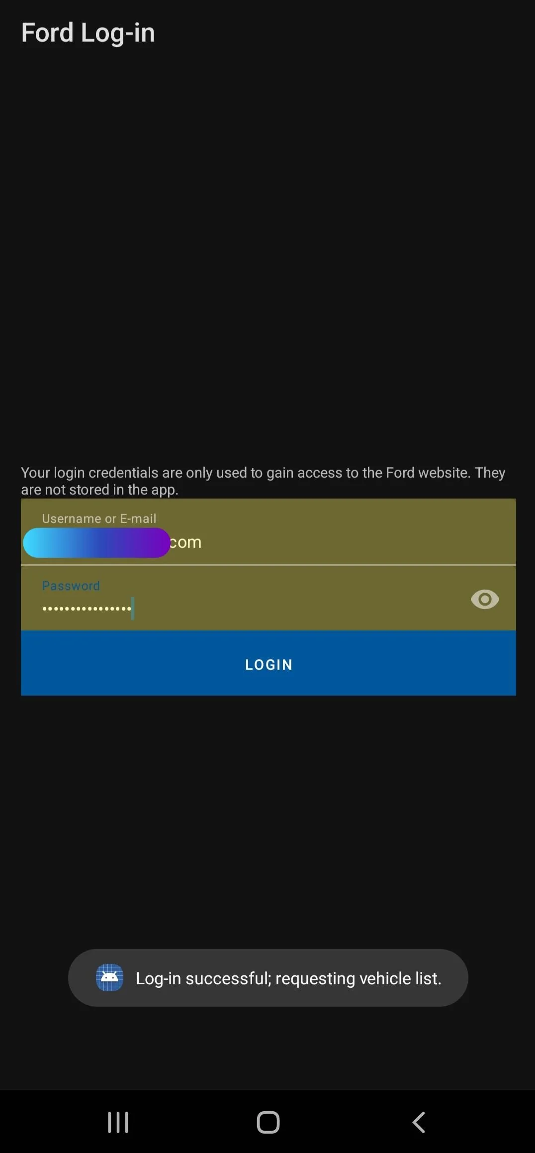

Were you already using the app?
I've been having the same issue since last weekend.
Says log in successful but unable to get vehicle list.
Been using the app since April maybe and love it.
Tried uninstalling and reinstalling. Same issue.
With the API change there's no way to fetch the user info, so it also can't fetch any vehicle info. I'll probably need to go back to having you manually enter a bunch of stuff.

Uploaded version 2022.12.26 to GitHub only (Play Store will be updated assuming all goes well here). This version contains new code to work around the recent API change. It's not possible to pull the user profile info anymore, so we're back to entering VINs and nicknames manually. There is a new menu option names "Manage Vehicles" where you can see which vehicles are being monitored and add new vehicles.
I've tried to make this invisible to anyone whose app currently works fine or who got hosed after login again. As long as you didn't wipe the app's data or uninstall/reinstall, it attempts to pick up the prior user/vehicle information and "fix it", but worst case.... just start from scratch.
If I don't hear about any issues arising, I'll push out to the Play Store in a few days.
