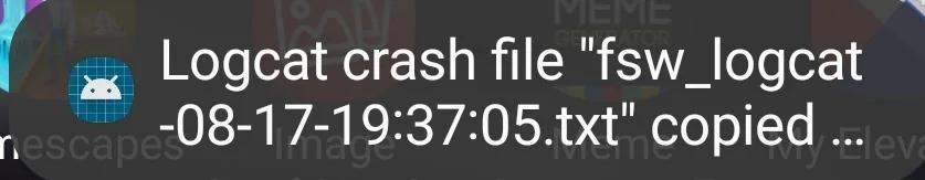

This looks awesome.
Just tried it and got a crash error.
This is 2023.08.17 on a Samsung S21 Ultra.
Ford F-150 Android widget Screenshot_20230817_193729_One UI Hom

Had the same issue. After I uninstalled the older version and installed the latest one it seems to be working fine
Okay thanks. Mine was a fresh install. It never had a previous version. Have been talking to Kenneth behind the scenes and he is looking into it.
