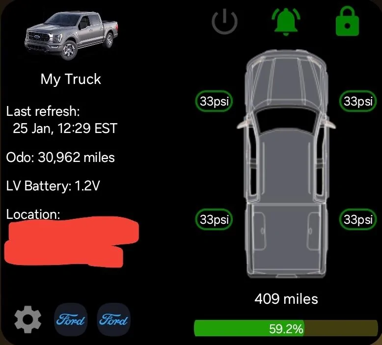

I'm testing out the next GitHub release for the rest of today. With any luck it will be pushed tomorrow. Be advised you will need to log in using your FordPass credentials since none of the previous authentication tokens will be valid. ?
kennelh
kennelh
Louise and Ken
Feb 21, 2022
177
280
Northern California
2021 Mustang Mach-E, Premium RWD
Incoming... let's see how this goes. Remember, only the GitHub version. If it seems stable I'll push a Play Store version. Please report anything you find incorrect or odd.
camattin
Feb 20, 2021
High Point, NC
2021 F-150 Platinum Powerboost 4x4
Nice to have this back!
Ford F-150 Android widget Screenshot_20240125_123042_One UI Hom
