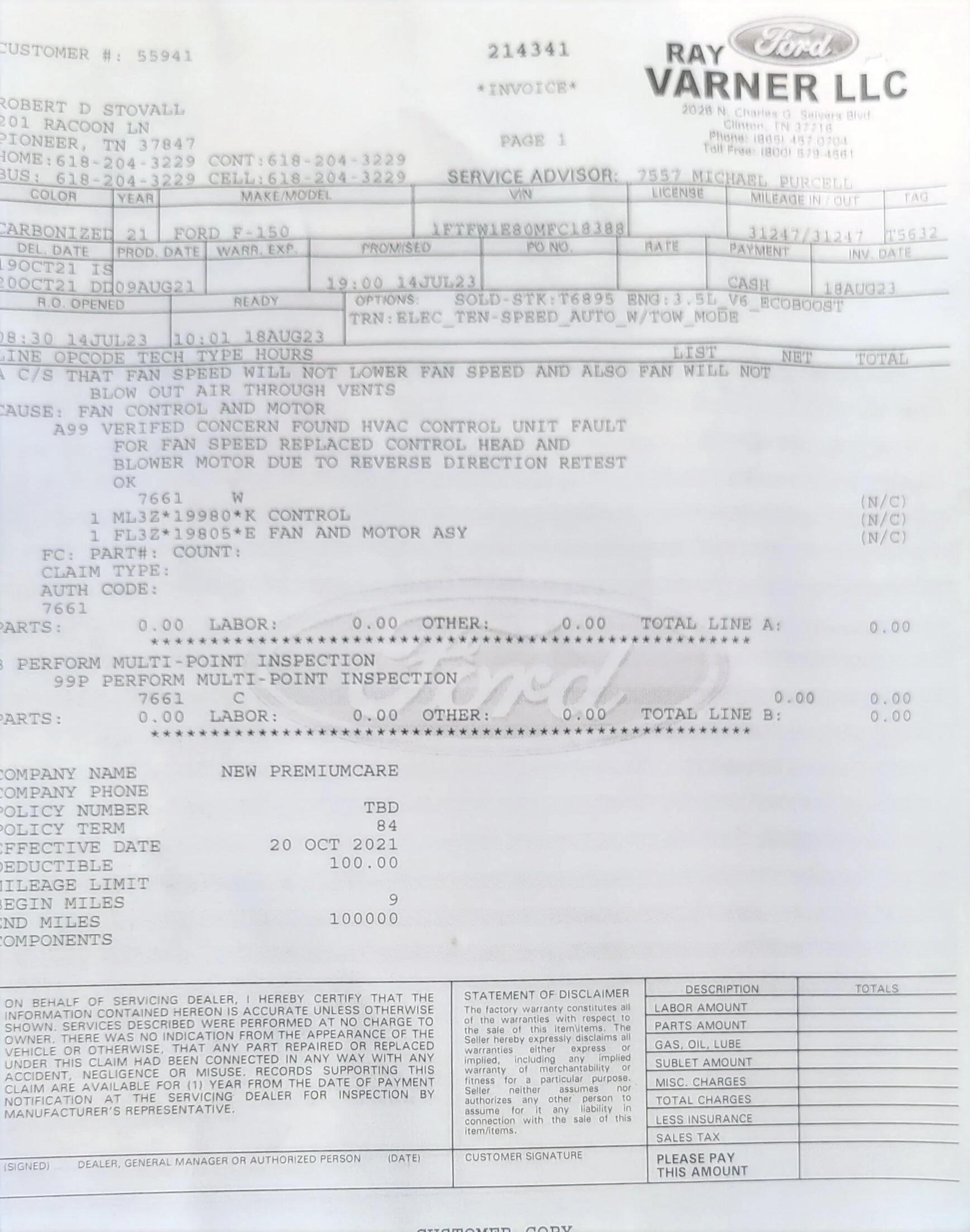

I have been experiencing the same issue since April of 2022. I have a 2021 F150 Lariat 502A. Took delivery 10/20/2021. Overall been very happy with the truck and services from my selling dealer Ray Varner Ford in Clinton, TN.
The issue just like many others, after a period of time, maybe 30 minutes or 6 hours, the system stops emitting air out of the vents even though you can hear the fan blowing behind the dash, even able to run fan speed up and down and change airflow on dash from defrost, main, floor, or any combination without positive effects. Just like others, I can turn it off ( just the HVAC and or whole truck) for approximately 15 minutes and system will resume working as intended.
As I don't use the truck everyday I put up with the inconvenience for about 2 months as it would work fine on most trips under 2 hours. Finally I reached out to the dealership in June of 22 and they were busy and ended up being August before they could get me in. Still they have been great trying to resolve my issue. Truck was repaired in September of 22 with parts shown on attachment, and worked fine until July 23 and resumed its non blowing issue. Contacted dealership, they checked it right away and ordered parts. Once parts were in they repaired it again, same parts replaced. Picked it up at 1:30 pm and by 5pm that same day it stopped working before I even got home.
Attached is my two letter letters explaining issue to service department and the last repair invoice that's the same as repair from 2022. So now 3 parts all exhibit the same anomaly, I doubt it's a component issue, but what's talking to the component.
As touched upon by another poster, I too believe this is a software issue not a component failure issue. Electronics/ microchips typically either work or don't work, no intermittent functions unless there is an electrical short / ground issue. That said the chips do what the programming / signal tells them what to do. I find in AUTO mode my issue occurs quicker that if I manually set my temp, fan speed, and airflow controls. Still it stops blowing either way.

I will return to the dealership, not giving up but need to examine the issue from a different perspective. Replacing the same part for a third time likely won't change my condition.
Your work around sound valid, but agree with your sentiment.
