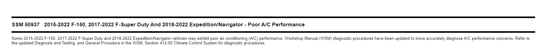

The easiest way to know if you need a new evaporator is to use the PID in Forscan. Set the EVAP temp and Vent Temp. If the Vent temp is lower than the EVAP temp you need a new Evaporator. Really need the sensor but ford only offers the entire HVAC Box. They have to pull the dash.
That is the test the dealer is to do in the TSB. As fas as I know the TSB is still relevant and active.
Edit - The TSB is gone and has been replaced with a SSM. the issue is known though. The WSM now has the proper testing process.

Can someone post the workshop manual for this? 50937 according to jesse
