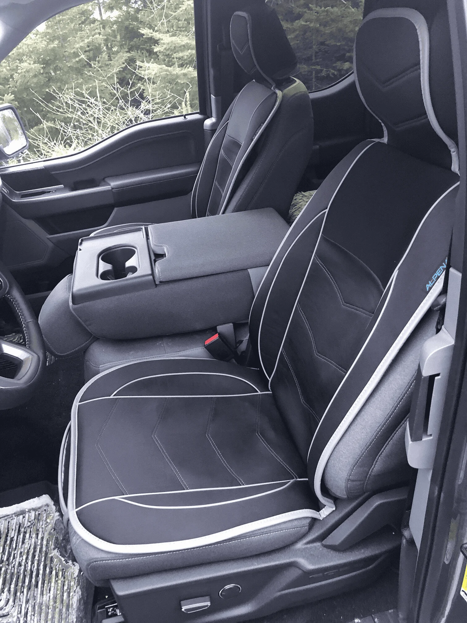

...the kid who gets the middle seat gets the shaft when it comes to turning on the butt warmers.
I would consider this a feature to encourage character building and a way to illustrate that life isn’t fair and let the kids decide who gets the center seat and hopefully they will rotate out so that one doesn’t get the cold seat the entire time.
I knew that society was in trouble when I saw a shopping cart with an attached plastic kiddie car and there was a steering wheel for both kids.
Ford F-150 Adding MIDDLE rear heated seat...how? A701EC3B-7EDD-425D-98A6-B81C192C705B
Failing that angle, there’s also electrically heated vests and jackets that run on many of the popular battery operated tool platforms. Though then; you’re stuck in the same spot as you are now, since the heated jacket might be more popular than the heated seats :p
