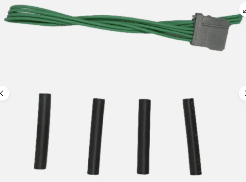

Which harness is it, can you provide a pic?
My mistake! Veiwing the harnesses on line, the harness that showed a picture with the part number MU2-Z14S411-MA not MU2Z-14S411-SA for the rear seat pigtail
You’ll need the wiring diagram to figure them all out
