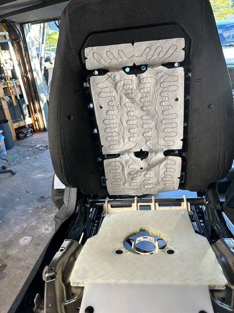

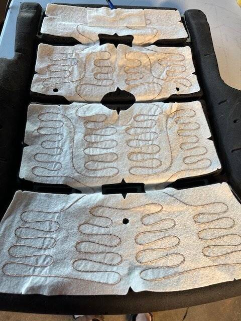

I recently added XLT 302a heated seats to my 301a. Before I did this, I searched a lot to see if there were any how-to write ups and I could not find anything for only heated seats so I thought I would post how I did mine. This is a big Job, very time consuming but it is not impossible.

I do not have the part numbers for the terminal pins. If someone wants to chime in, feel free. You will need 2 different sizes for the plug in on the HVAC module and another size to get power for the HVAC module with connector C265. I bought a used front seat harness MU5T14D230 from eBay for $40 and de-pinned the terminals I needed and soldered the wire leads to the new harness. This worked out pretty good as there are a lot of different sized pins in this harness and I will have a lot of terminals leads for future projects. This will be a 6 wire 22 or 20ga harness that will go from the back of the HVAC connector C228B and split off to each seat like a T shape. This is a crude drawing I made up of the harness and a picture of the harness. 4 of the 6 wires are pinned. One of the other 2 is a ground. I attached this to a factory ground point behind the HVAC module. The other wire is a signal wire. I used a quick wire tap connecter and spliced it in to wire 2 on the C228A connector. The other end of the harness are connectors for the heated seat pads. I chose to plug directly into the heating pads because I didn't feel like the extra time to run the harness to the underseat connectors C311 and C312 was worth it. However, maybe I will do this at a later date for more of a factory look.
